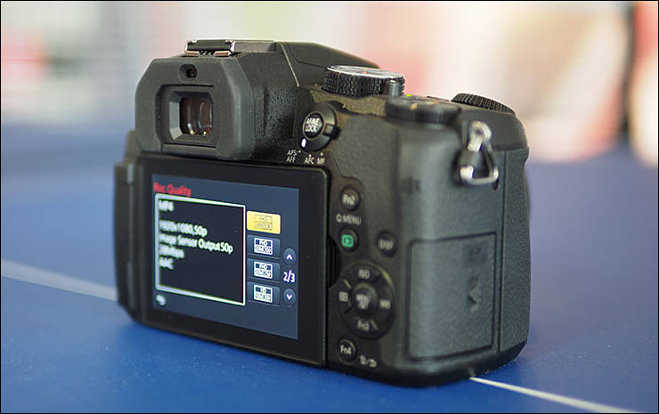

B&H photo first look
OK, so in the above video, the Panasonic rep says you CAN use external monitors/recorders AND record/monitor internally at the same time. HOORAY!!
BUT, he says that it only records 4:2:0 internally. BOO!!
I think it was some misunderstanding, and it is HDMI that is 422 8bit, as with FZ2000.
Bhphoto video says it records 8bit 4:2:0 internally.
I'm getting confused: I thought the FZ2000 had 10-bit HDMI out?
Yep, but also 422 8-bit mode. It'll be all more clear in coming days.

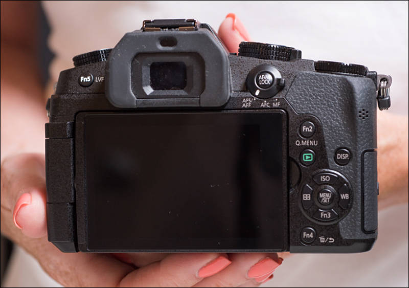

https://www.dpreview.com/news/3393180242/hands-on-with-the-panasonic-lumix-dmc-g85
There is no headphone socket unfortunately, but now we can stream to an HDMI monitor while recording 4:2:2 to the memory card.
