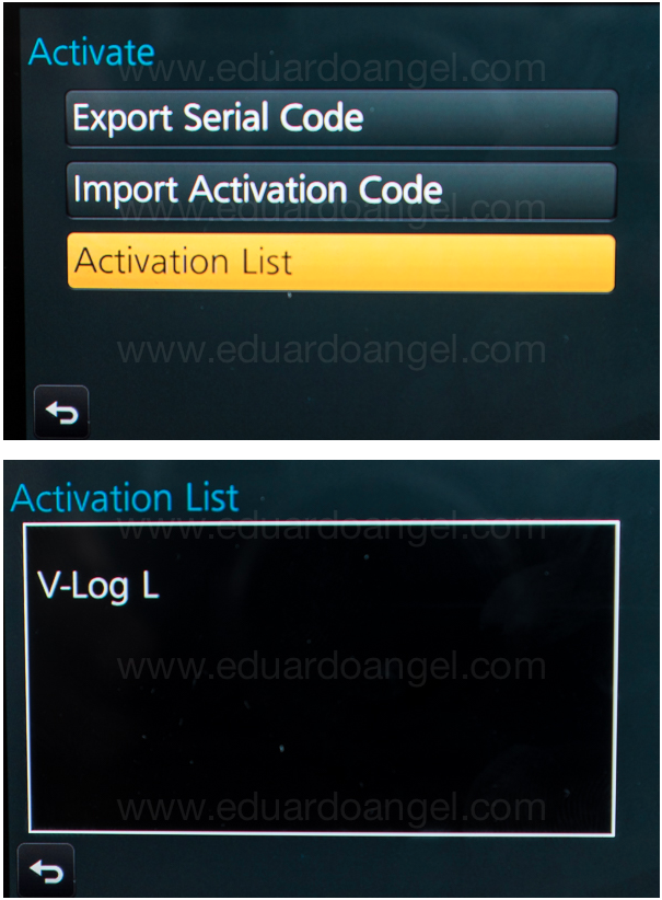

Just found this online from http://www.eduardoangel.com/2015/09/01/panasonic-gh4-vlog-tutorial/ (web link supplied so you can see I'm not photoshopping the info)
Is it ONLY me- or is it strange that there is now an 'activation list' menu item in the GH4???! Is this going to be something that becomes the new standard with new features? 4:2:2 activation next most probably! :-(
My point is you wouldn't have this menu if there was only going to be one.
Sounds like Panny are using V-Log L as a testing ground for future feature updates me thinks... Maybe it will be: why buy a GH5 when you can pay for updates on the GH4? If it makes 'free cash' for Panny the business logic is there I suppose. I can see the new P-V forum title:
