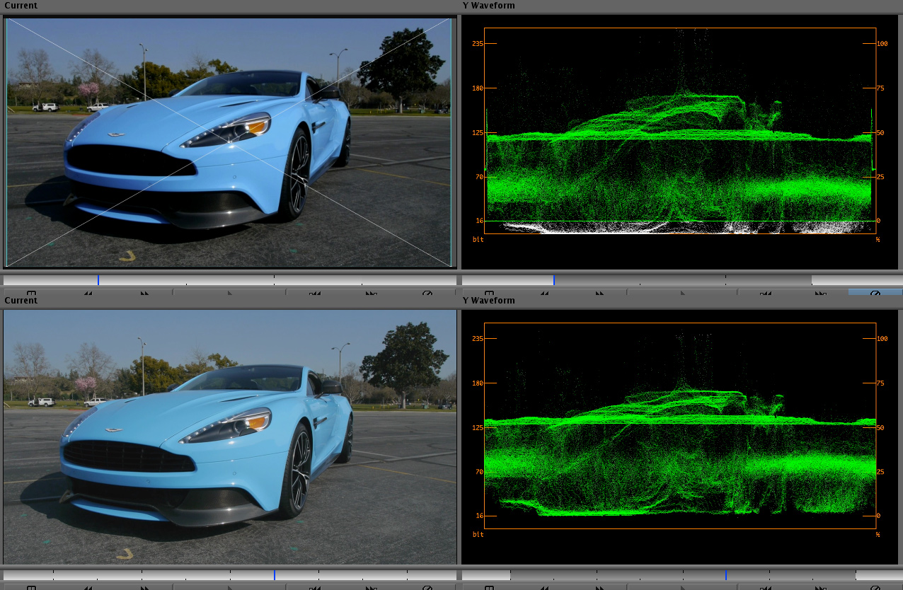

  • Not sure if I did something wrong but I would not use Moon for 720p60 right now. I have never seen banding in anything this bad in a long time. From well exposed shots to slightly underexposed shots to save highlights. Moon in 24P is amazing but I don't even think I can grade this 720p60 footage. As soon as I do I get massive blocking and there's banding everywhere. I have never seen anything like this in any footage I have shot. Now I usually shoot 24p but the client wanted 30P as the final output with the ability to slow down footage. I'll post grabs in a bit. I'm very confused here as I have never has any problems with any footage from Driftwood hacks.

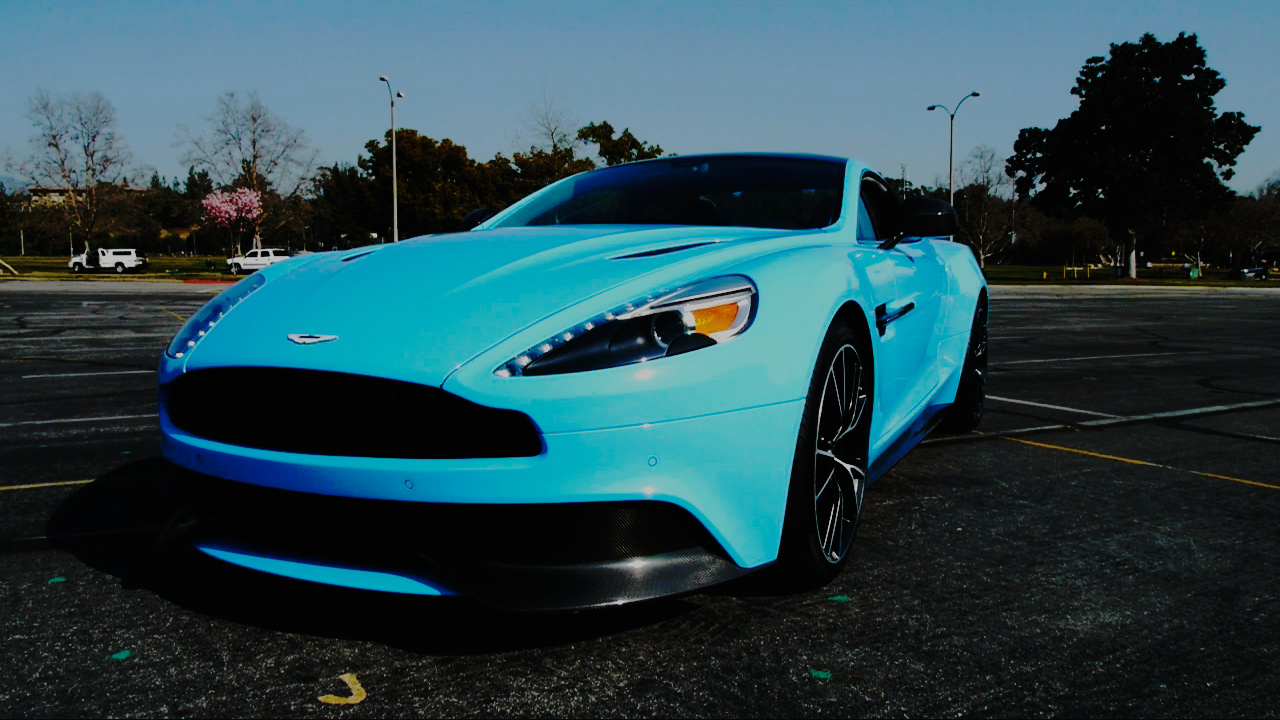

  • Here's the before and after a slight grade in CG just to show what's going on. Never mind the car not being in focus, this is just to show what I've done wrong, whatever it was. Look above the car, about in line with the street lights. I have this type of banding in every shot, in many different exposure levels.

  • @towi I have no idea what frame it is. I'm on a mac and can't use that streamparser tool. Where would you like me to upload the .mts file? I went frame by frame in mpeg streamclip and it looks like it's on all frames there for whatever that means. I have another file that's far worse than this and when I rack focus there's rainbows of banding on a seat that move all over the place. Very odd. It seems it's worse on the 14-140 but it's there on my Tokina 12-24 and Rokinon Primes as well.
    Any help I can provide I will!

  • @vicharris I'm not sure if that was a test shot or something you got to save, but if its something you gotta save, I'd suggest transcoding to prores HQ or DPX in 5d2rgb first, then upressing to 1080p in AE, then attempting to grade. It may not help, it may already be what you are doing, but I've found that if I don't convert my 720p footage in 5d2rgb to prores HQ first, it degrades significantly. That said, banding is always a problem in 8 bit. It sucks. It is the only thing really that still has me considering buying a red.
    Oh, one other thing but you can also download resolve 9 lite and mask that sky out of your grade. Again, this may have only been a test so it may not be an issue, but if you gotta save that footage, thems my suggestions in case it helps...
  • @JDN I do the whole 5D thing first to HQ then bring in to the FC6 and grade via Shians recommended settings using CG but I see the bad banding even before then in all the footage. Like I said, I've never sen something this bad but I've seen many other people experience this type of footage so maybe I screwed the pooch this time. Also, sadly NOT test footage! :(

  • @towi I'll get on that right now. Most of the file is crap but once you get to that angle you can see what I'm talking about. I'll pull up other more controlled once to send to you as well.
  • @vicharris
    since the scaling is a bit different I couldn't find the exact frame. But I and P frames do not really look different here …
    Now, this is not really an issue with the file but with decoding or transcoding. Streamparser shows some skipped macroblocks and this may (or may not) contribute to the posterization you've encountered. However the actual issue is that the video gets decoded (or has been transcoded) to fullswing in 8bit (0-255 luminance levels). But the actual file is studio swing (16-235 luminance levels), see here (your screen grab on top): image
    So the luminance levels of an 8bit file have been stretched quite a bit with (only) 8bit precision and this alone can introduce banding/posterization. I assume your color correction is also rendered in 8bit. This will emphasize banding/posterization even more.
    I've applied a heavy curve to your original video in Avid (16bit rendering)… but the sky shows no banding (well… almost none):image image
    I've applied another curve to bring the luminance back down (so there are actually 2 steep curves torturing the image). But since I've started with the correct levels and the rendering of the curves is 16bit you won't see (serious) artefacts: image
    What editing software do you use? Is it suitable to work with DNxHD codecs? If so and since you are also on MAC my advice is to transcode to DNxHD (10bit) with iffmpeg (great tool!!): http://www.iffmpeg.com/

  • @towi Wow, thanks for looking into it. I use 5DtoRGB, transcode to 422HQ, then CC in FCP6 using Color Gear and switching the sequence presets to 10 bit YUV for rendering as suggested by Shian. Like I said before I would love to CC in Resolve but my GC isn't good enough. I guess it's time to upgrade to a Hackintosh this week eh!

  • @vicharris
    basically your workflow is okay. The original MTS file is also okay ... so the issue has nothing to do with Moon.
    hmm... I have no idea what's going on. Something is not right either in your processing pipeline or with your workflow ... but it's hard to tell from a distance.
    Looking at your screen grab of the uncorrected image it's too dark and it's oversaturated (even if I throw out your monitor profile). I've just transcoded your MTS file through 5DtoRGB with "Broadcast Range", "Full Range" and both modes also with "technicolor cine style" applied. I am on my laptop right now so the display is limited and I have no waveform to look at. But visually all 4 conversion look okay to me (however I would avoid to apply the technicolor cinestyle curve). So I suspect there is something wrong with your import- or project settings in FCP... but, again, since I am not at your computer it's hard to tell. Maybe start again and try to convert through 5DtoRGB with "Fulll Range" (which is the correct setting anyway since it preserves the "full range" of the source file. "Broadcast Range" remaps the luminance levels to fullswing).
    re iffmpeg: open the site in Safari... the site doesn't work with all web browsers. But since you use 5DtoRGB there's no need to use iffmpeg. And since you edit in FCP ProRes is the way to go anyway ...
