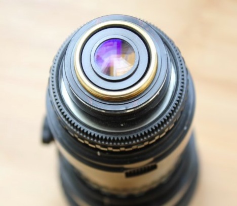

  • A couple photos of the Canon TV16 25-100mm
    1600 x 1200 - 881K
    1600 x 1200 - 941K
