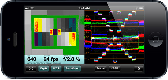

I realize what I'm about to do is a little dangerous in the wrong hands, but this app is too damn cool not to share, and it'll prepare you for a future where everything has FC and WFM and nobody really uses light meters..... oh wait... I guess that's the present.
http://www.adamwilt.com/cinemeter/index.html
I will do a tutorial on this at some point. At it's default, It is calibrated perfectly with my digisix when using my iPhone 4. There's doesn't seem to be the pink 49-51IRE range on the FC side, but by using both the WFM and the FC, and playing around with it, you can teach yourself to use both to be able to read a scene in the field and/or breakdown the light in a scene very quickly.
from the developer:
UNDERSTAND THESE LIMITS:
The light meter is absolute—you can count on its readings to mean what they say, regardless of circumstance, since they’re calculated from the camera’s reported brightness value. Once you calibrate Cine Meter to your reference standard, it should always give you correct readings.
However, the picture, false-color picture, and waveform monitor displays are only relative—they show scene brightness values relative to other levels in the scene, but the levels of those images and waveforms depend on how the camera sets its exposure, which often differs from the brightness value the camera reports to the light meter, as described in How It Works.
For this reason, you can’t directly compare light meter readings with waveform or false-color levels!
You can’t preset an exposure level or a white balance and then use the displays to show you absolute levels. iPhone / iPad / iPod touch cameras don’t let you manually preset values; they only let you lock in the current auto-exposure or auto-white-balance setting, so you can’t set the scopes for, say, ISO 800 @ 1/48 sec @ f/4.0 with a color temperature of 3200K.
The only way to set a particular exposure level is to trick the camera by showing it the “correct” light (for example, using a gray card) and then locking its settings. Once locked, you can then look at the pictorial displays to see how tones and colors in a scene render relative to the locked settings.
That’s the key to getting the most out of Cine Meter: treat it like a point-and-shoot camera with exposure and white-balance locks (which is really what it is, only with fancier readouts), and you’ll be able to “fool” it into doing what you need.
                  One of the best things is the ability to use the waveform monitor to check evenness of lighting on a key background.

Thanks for the heads up on the cinemeter, downloaded it just now, amazing. I have been wanting to sign up for Color GHear for a while now, you have given a heap 'o great information here. But I'm one of the new owners of the BT Red One MX's and spend most of my time trying to wrap my head around Red workflow. I'm learning RCXpro now and dealing with LUTs, all new territory. Will I be able to find tutorials that I can apply to using Speedgrade, as well as your lighting tips?

@shian Really looking forward to that CineMeter App Tutorial. Still trying to wrap my head around how to implementit with my gh2 and shooting a scene correctly.

Shian - I would also love to see a tutorial on the CineMeter iPhone app. Given the limitations of the iPhone, can you suggest settings for where the false color ranges, and how to test the results with a waveform monitor?
