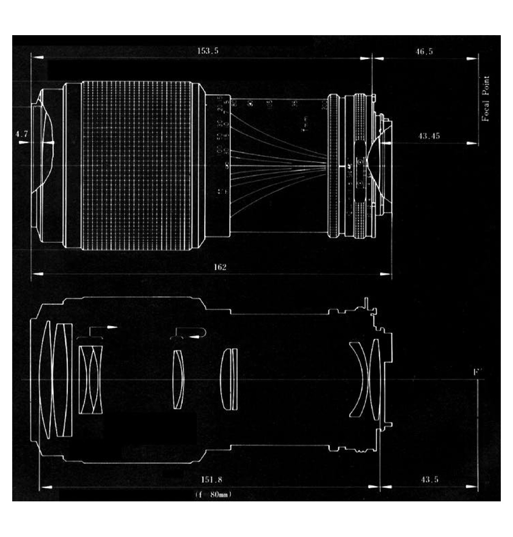

Though I thought "I'm done with push pull motherfuckas", sometime ago I end up adopting the sentimental grandpa Nicasio aka nikkor AI 80-200 f4.5 at a relatively cheap cost: 40€
Despite it had all possible diseases, from arthritis to parkinson and a loose prostrate, from all push-pulls I've tried is the easiest to maintain (para)focus. Add to this solid metal construction and a real nice fat 200º throw focus ring (almost as nice as vivi 70-210) and we're half set to give grandpa Nicasio a chance.
But there was something very irritating, the squeaking and the beyond mourning, also the ring wasn't as loose as I would like, probably lack of lub. Glass had an ecosystem of it's own too :P Black tape strips just gagged the issues.
So today finally I put hands on it and amazingly didn't kill the bastard, quite opposite, declicked it (very easy actually), lubbed and clean each element. But, as I never take pictures or do schematics, assembled it wrong, ja ja ja, inverting 3rd and 4th element or something like that. Luckilly we have internet, so a quick look at the blueprints and that was it.
