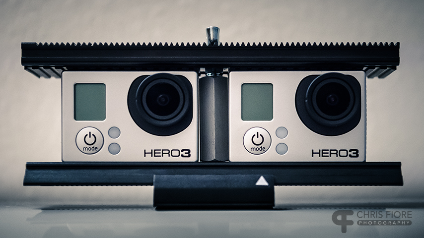

DIY 3d case?
@stonebat Yup! Made from a couple of macro sliders and misc hardware. :3 Stripped the rubber grip from the bottom one, so the GPs can parallel align to the left over groove. Found that just tossing 2 on one slider with the tripod mounts was a headache, so I ditched the cases completely. Hopefully GoPro improved their tolerances for lens mounting on the new cams.
There's also enough room for all power and video cables on both, and can push the cams out to the sides for shooting distant objects. If I can figure out how to make the right kind of mounts, I can also set them up like the original 3D housing, too, though that's not on my list of priorities. At the moment, the they're a little further than intraocular distance, but that's fine for now.
Testing for the next 2 days, since the weather's finally clearing up around here. If all goes well, I'll be shooting a drifting event on Sat! :)
