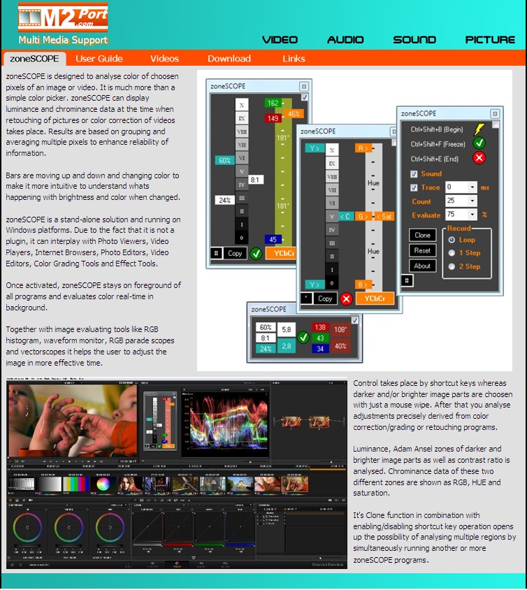

Now I started to build up a website for zoneSCOPE. You can already download and try it. As soon as I have more time I will put it on a seperate thread. Hope you have some ideas for improvements.
Enjoy!
@vicharris Thanks for the positive feetback. I thought that people would laugh and say I have my RGB parade, my waveform monitor, my vectorscope, my calibrated screen and my power windows where I also can focus on things like that. I see its especially usefull if one starts to learn color grading. It's useful to analyze a look of a movie and learn about the behavior of different grading tools.
Just come back to the point of contrast ratio. When it comes to a change in contrast ratio during grading its easy to see that you always have to draw back saturation. How much you have to draw back you can immediately analyze precisely with this tool. With Davinci Resolve its amazing to see how good Luminance and Chrominance can be separately handled due its YRGB color space treatment.
@shian you are right. This demo is really technical and my aim was just to show that it works. I might think about commericalizing this program but this will be hard work to do it proper. And many thanks, a good teaser with legal images would help. The cheat sheet which you use for your tutorials is very helpful. %-values do perfectly fit to Luminance Rec. 709 calculations. The S-curve (RGB vs Zone) can also practically be achieved when you expose 18% gray-card differently with a camera like the GH2. Just analyze resulting RGB values and divide them into 11 zones. That was a proof for me to take this sheet as a base for luminance calculations and not other published data mainly based on Lab color space results.
Meanwhile appearance of zoneSCOPE program has changed a little bit. Just a demo how it looks when focusing on Luminance. It also works with Chrominance.
zoneSCOPE can analyze certain parts of an image or video. It's an independent (Windows System) running program and can be used together with different Software Systems like Internet Explorer, Media Player, Photoshop Pro/Elements, Gimp, Adobe Premiere Pro/Elements, Adobe After Effects, Sony Vegas Pro/Movie Studio, Magix Pro/Video Deluxe, DaVinci Resolve etc.
@shian sorry that I tried to express too much by few sentence. Maybe its best idea to show on demo video how it works stepwise. In general my aim is to have an additional tool to follow (your) lightning tutorials and also be able to quickly analyse small regions like as usually done by region selection with power windows in combination with looking at vectorscope/waveform monitors.
I have also some basic issues like you would realize on above picture where I would measure a contrast ratio of 17:1. I'm not experienced but I assume you would say that this value is much too high.

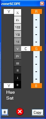

Hi @shian, just follow-up discussion which I started at color ghear topics on Adam Ansel system. I'm still confused what you can find on internet and in books when it comes to the application with real numbers for color video. In my spare time I work on programming what I call zoneSCOPE. You can just see a screen grap of it in attatched file. Zone detection is based on Rec 709 Luminance (Y) calculations non restricted range of RGB = 0 to 255 which is then Y = 0% to 100%, zone 0 to zone X. With the picker you are able so select several points by just moving the mouse and record them in a loop, in 1 step or 2 steps. Recording them in 2 steps is convenient when it comes to measurement of contrast ratio as its better to use two different areas. Hence its relatively accurate against noise. It can be used with all kind of grading tools (Sony Vegas/Photoshop/DaVinci Resolve etc.) as it works independently on the top of the screen and starts by shortcuts of keyboard.
___
___
___

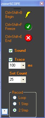

During grading you are directly ("online") able to see what you change. This includes Y_high, Y_low, contrast ratio C based on Adam Ansels zones. Hue and Sat is based on YUV to be comparable with most vectorscope results (Maybe I should include Hue/Sat based on YCbCr Rec 709). RGB meter is based on Mean value of all selected points and very useful for skin adjusment (purple/yellow). On other than skin colors it will certainly change the order.
To compare different shots a screenshot copy of the zoneSCOPE can be automatically attatched to the right or bottom.
