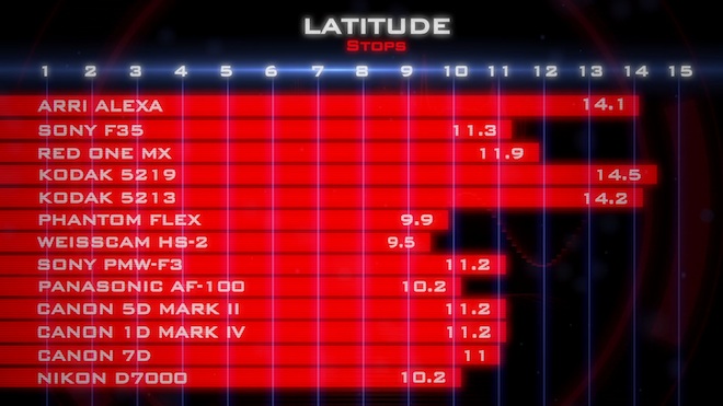

  • how they make conclution about this chart
    http://www.personal-view.com/talks/uploads/FileUpload/22/42a2254b720cbd8cc72a1b9b4c1344.jpg
    any article to explain about the gain latitude stop?so i'm confuse now..
    thanks to explain me
    660 x 371 - 94K
  • What do you mean? "any article to explain about the gain latitude stop?so i'm confuse now"..???
