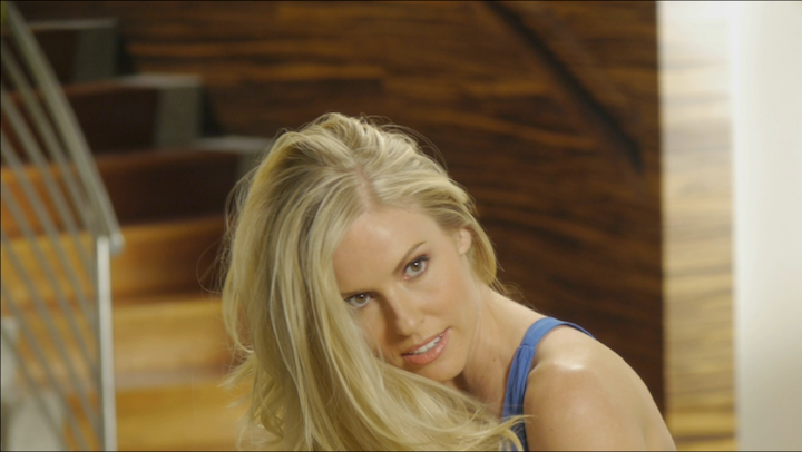

I did a quick color correction on the clip for fun. It certainly wouldn't be hard to get the colors and skin tones to match up if I spent more time on it. Although the difference in resolution does show (but this is between 3K and 720p so what would you expect) I would certainly not be opposed to using the GH-2 as a B-Cam to an EPIC for Broadcast television or web, Joe public would never notice the difference in resolution and I doubt a client would unless you pointed it out to them, it is less apparent with motion. I would love to play around with uncompressed files or see some 1080p compared to the 3K.
I should've mentioned that I did some quick matching myself.

@kholl, I think your matching must be off. The second seems significantly darker than first. Or maybe my screen is bad.

The first is the original GH2 image, the second is the matched-to-Epic image.
Nah, no denoise, just color adjusted really quick.
