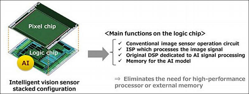

    The new sensor products feature a stacked configuration consisting of a pixel chip and logic chip. They are the world's first image sensor to be equipped with AI image analysis and processing functionality on the logic chip. The signal acquired by the pixel chip is processed via AI on the sensor, eliminating the need for high-performance processors or external memory, enabling the development of edge AI systems. The sensor outputs metadata (semantic information belonging to image data) instead of image information, making for reduced data volume and minimizing any privacy concerns. Moreover, the AI capability makes it possible to deliver diverse functionality for versatile applications, such as real-time object tracking with high-speed AI processing. Different AI models can also be chosen by rewriting internal memory in accordance with user requirements or the conditions of the location where the system is being used.

      The pixel chip is back-illuminated and has approximately 12.3 effective megapixels for capturing information across a wide angle of view. In addition to the conventional image sensor operation circuit, the logic chip is equipped with Sony's original DSP(Digital Signal Processor) dedicated to AI signal processing, and memory for the AI model. This configuration eliminates the need for high-performance processors or external memory, making it ideal for edge AI systems.
