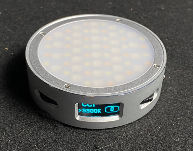

Godox R1 and RF1 small LED lights
    • High light quality with CRI 97-98, TLCI 97
    • 2500K-8500K adjustable color temperature
    • 605lux(at 0.5m)
    • 5W power
    • 0-100% light output adjustability
    • RGB mode
    • RF1 has wireless connection and cam be controlled via smartphone using Bluetooth
    • One hour battery life at full power (1,800mAh)
    • 76×24mm size
    • 170g

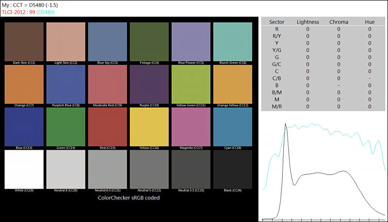

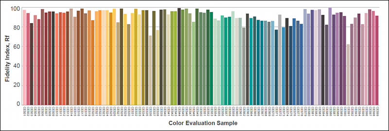

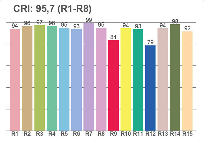

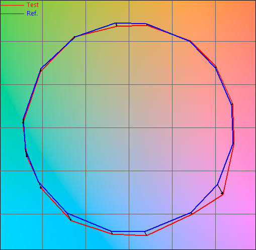

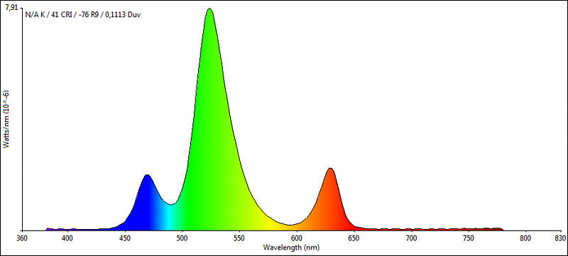

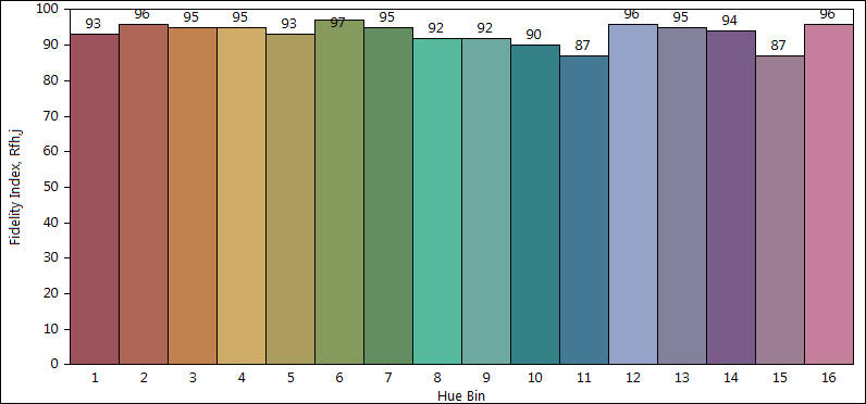

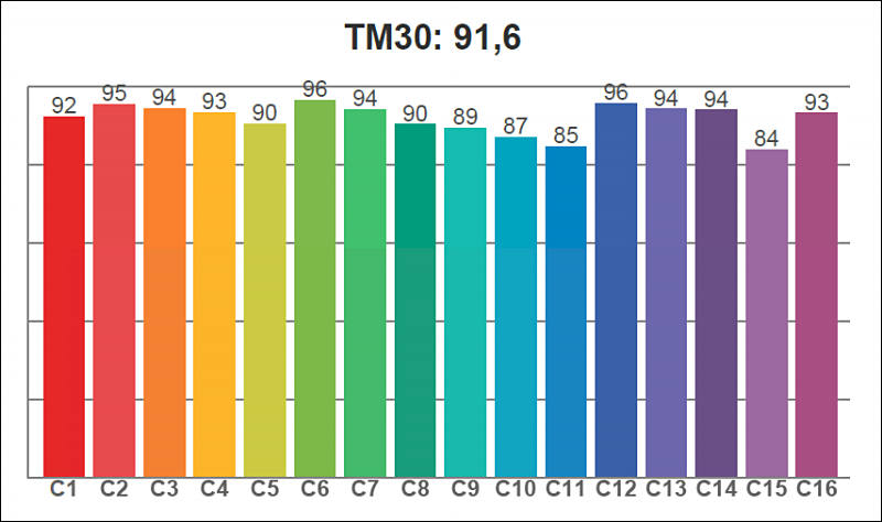

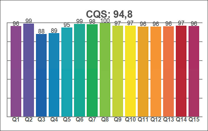

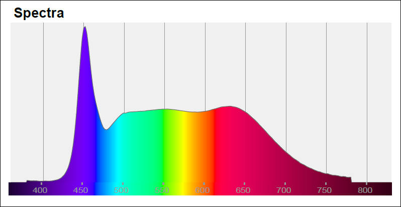

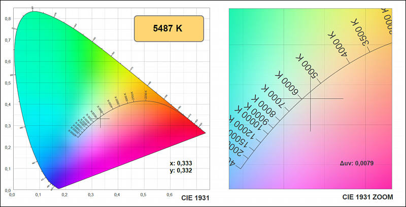

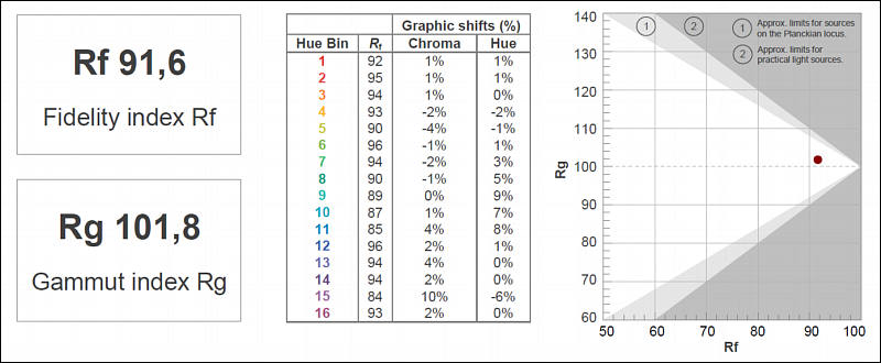

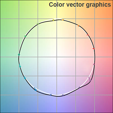

  • Godox R1 (Daylight setting), Measurement using CV600, Russian Lab processing
    Focus on TM30 and CIE 224 and look for color distortion and Rf values.
    Godox R1 is good light with light quality suitable for videos.
    Color temperature
    CRI color quality
    CQS color quality

    TM30 color quality
    TM30 details
    CIE 224 2017

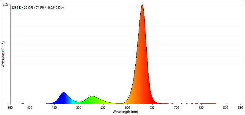

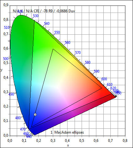

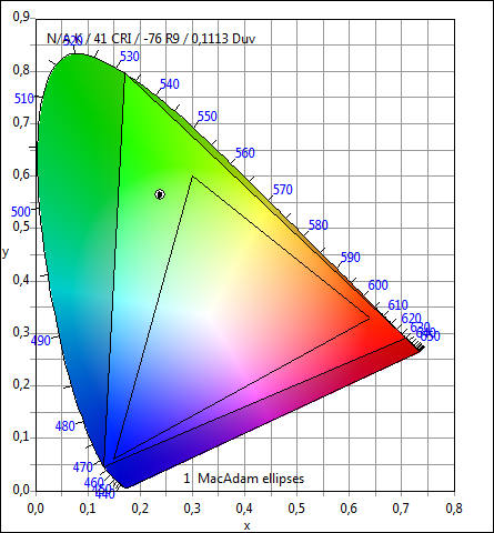

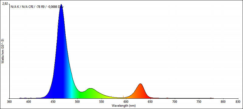

  • Colors
    RGB coverage is not very good, as usually nice led RGB lights are close to Rec 2020 points.
    R
    G
    B
