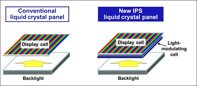

  • More details
    These panels can turn off the backlight on a per-pixel basis, granting them an advertised " over 1,000,000:1" contrast ratio.
    New light-modulating cells help the screens hit a maximum (and stable) brightness of 1,000 cd/m2
    All of this is very fuzzy, as it is LCD crystals that cut the light.
    May be they made special low bit second crystal having only 3-4 states (complete cut, complete open and something in between). And with very slow switch time.
