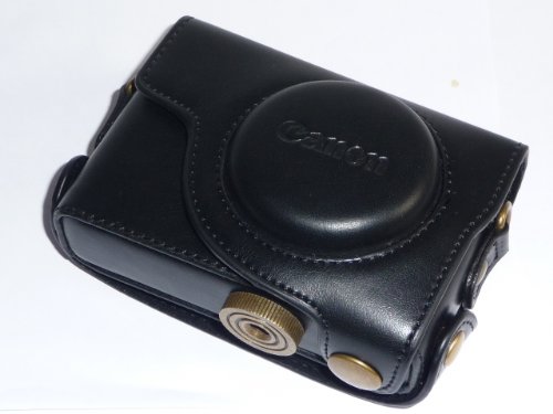

  • Hello I'm looking for a bag-bmpcc like this http://ecx.images-amazon.com/images/I/41Bt6UACQAL.jpg
    Where?? thanks
  • @kurt10 that does not make too much sense as different to a pocket photo camera there is no standard lens at the BMPCC. Which size should fit?
  • If it's going to have as small of a lens as the one pictured, it's gonna have to be the Olympus body cap.
    http://www.amazon.com/Olympus-BCL-15mm-Panasonic-Micro-Cameras/dp/B009DL0LOW
