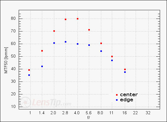

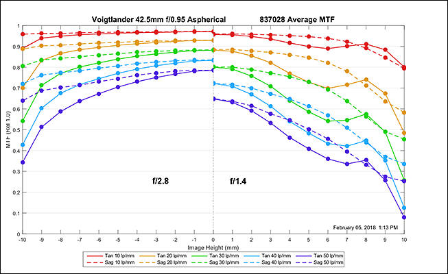

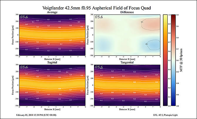

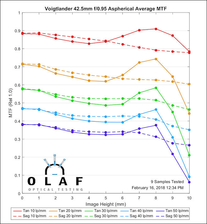

Measurements
https://www.lensrentals.com/blog/2018/03/finally-some-more-m43-mtf-testing-are-the-40s-fabulous/
