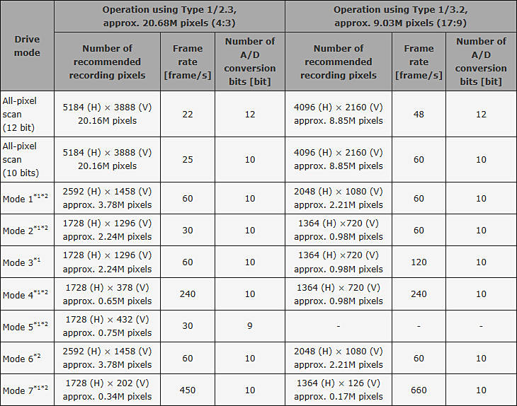

Glimpse at compacts future - 4K 60p 720p240 Sony Sensor
    • Diagonal 7.82 mm (Type 1/2.3) approx. 20.68M effective pixels (5256H × 3934H)
    • Pixel size: 1.20 µm unit pixel
    • Supports 20.68M-pixel imaging at 22 frame/s
    • Back-illuminated CMOS image sensor featuring high sensitivity, high dynamic range and low noise
    • Provides 4K video mode (4096H x 2160V, 60 frame/s)
    http://www.sony.net/Products/SC-HP/new_pro/march_2014/imx147lqt_e.html#Photo1
    730 x 574 - 119K

  • Bring it on Sony !
  • It's a shame that Type 1 and Type 2 look like two different sensors. I was hoping they were two different operating modes.
    Type 1 seems targeted at photography while type 2 is clearly targeted at video.
    Type 1 will definitely end up in the next compact camera generation but I haven't figured out what are the real target devices for type 2... compact video cameras? (most likely), cell phones (not enough MP for photo bragging)?
  • Not so...same sensor. they're just windowing it.
    At the same time, Type 1/3.2 cropping functions support 4K video format. The IMX147LQT is able to use both Type 1/2.3 and Type 1/3.2 image view angles as the situation demands.
  • Thanks @kurth. I didn't catch that from the OP. Should have followed the link, but I mistook it for the attachment. Very interesting indeed, but apparently targeted at compact cameras not cell phones.
