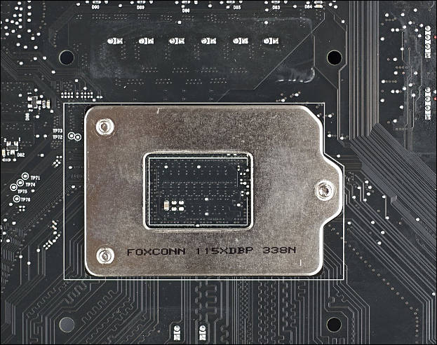

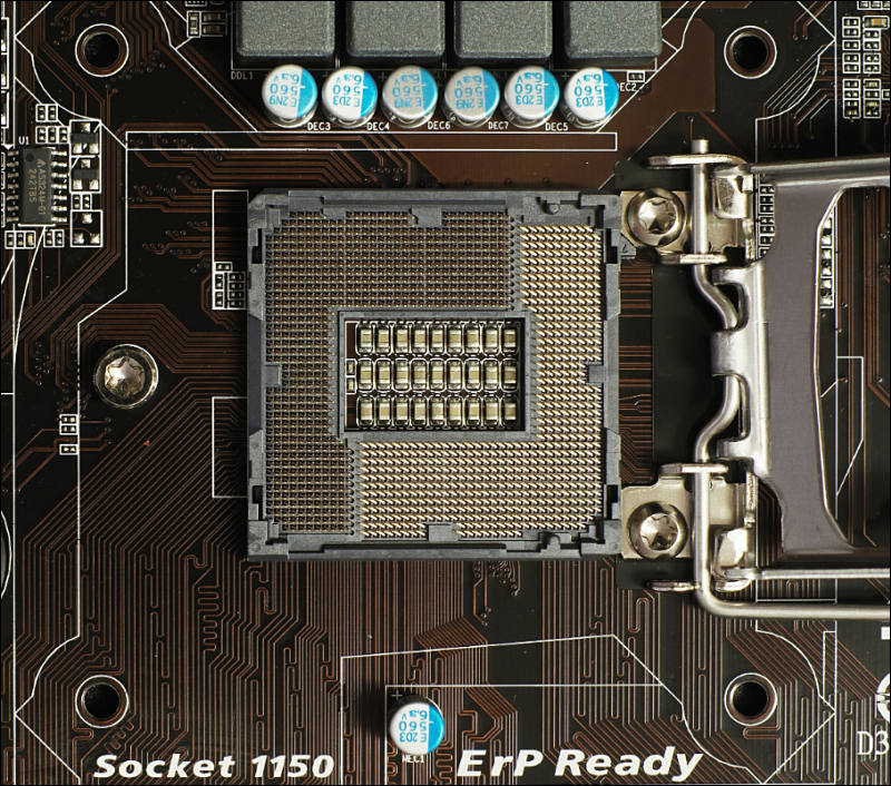

  • Standard Intel socket design
    On the back it looks like

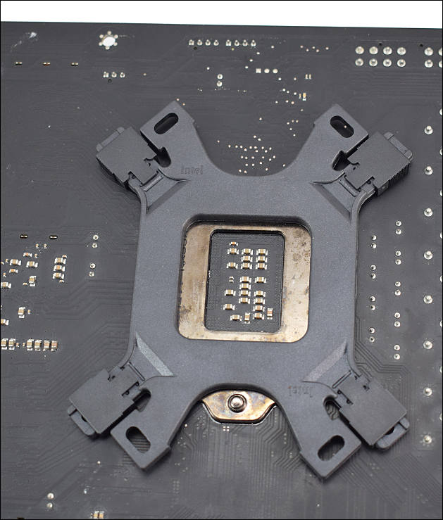

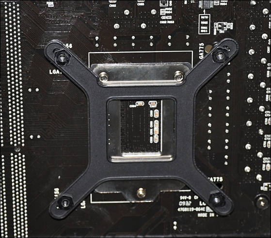

    Issue with it is that cooler mount is just 4 bare holes in motherboard - totally unacceptable solution for anything besides stock cooler if you tray to use them as they are. As motherboard will bend.

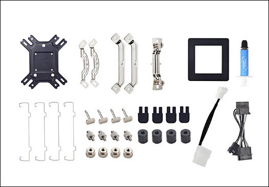

    So any good cooler manufacturer ship you their own extra backplate and mounting hardware.
    Typical accessories set
