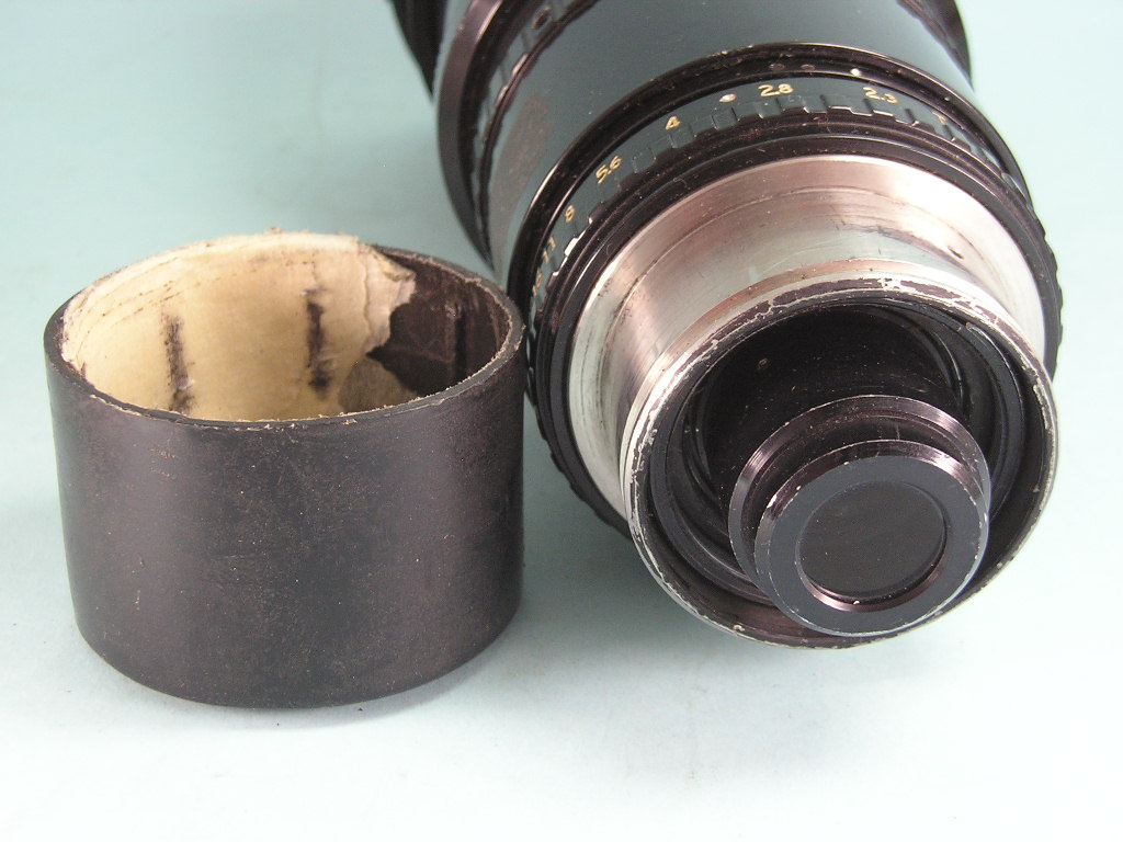

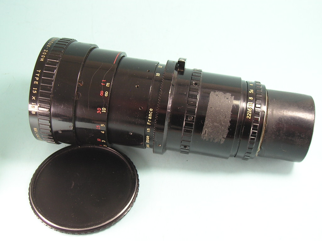

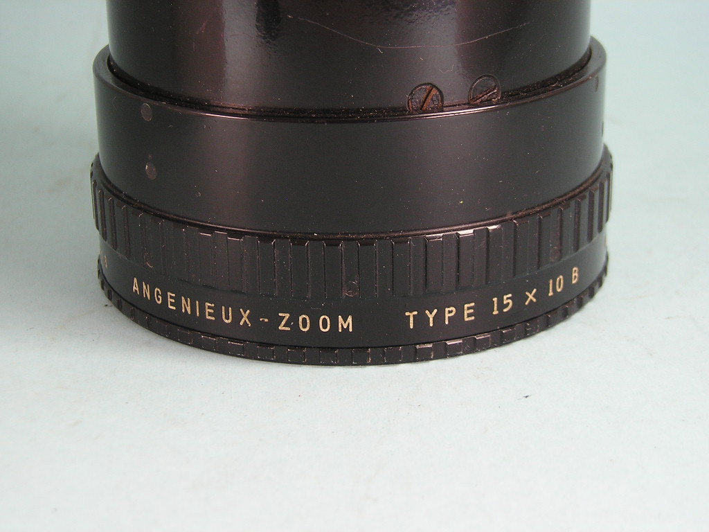

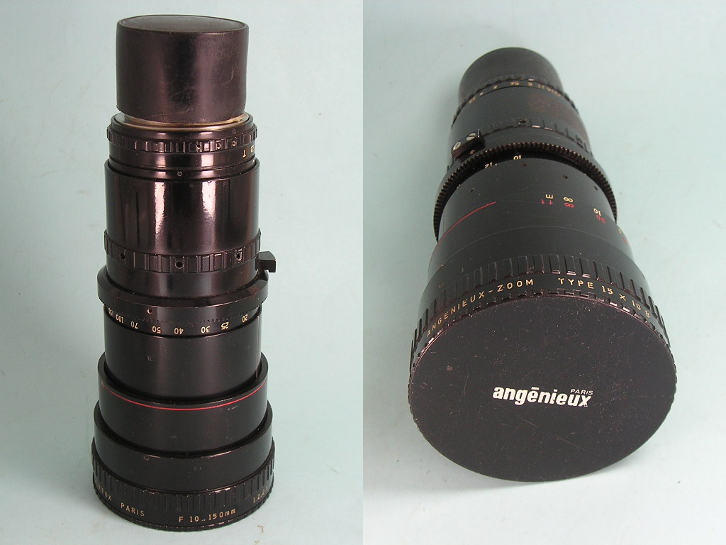

  • Hi all, I need your help... I'm trying to determine which Angenieux lens is this and what are it's specs? Most importantly, which mount type is this??? and how can I mount this on a GH13 m4/3 mount? All that I know is that this lens was once attached to a vintage 16mm Arriflex.
    And how much do you think I should pay for this lens?
    Any advice and suggestions much appreciated!imageimageimageimage

  • looks like an arriflex std mount, probably used with an old arriflex s16. i think i have the same one, payed 120 euros for it last year, works great on old arriflex cameras, tried it once on my gh2 has a lot of vingetting and for me seemed only useable in ex tele mode, does give a very nice image. STD Arriflex to Micro 4/3 m43 adapters are easily found on ebay. there is also a c-mount version of this lens
  • Thanks @MRijsemus , Yes, the guy said that it was previously on an old 16mm Arriflex. Do you know what's the zoom range of these? from the writings on the lens it's not clear. Is it 10-150mm ? and what's the F?

  • arriflex std mount
  • it seems to be 15x10B that would translate to 10mm-150mm and it would probably be f2.0
