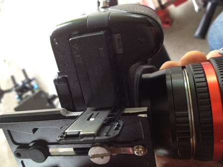

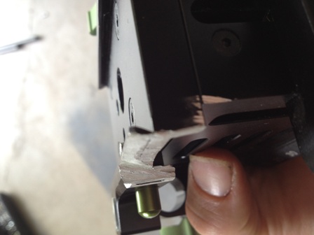

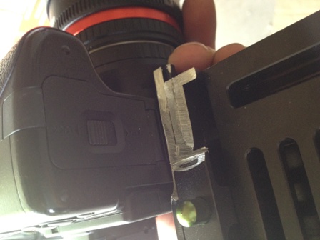

I have this lovely baseplate that I bought from Lanparte through PV to use with my GH2. I love it, but it's been a bit of a pain in the ass to use because every time I need to change the battery, I have to slide the camera off the baseplate and then pop the QR plate off to get at the battery terminal. I noticed that you could file down the QR to get the battery out, and saw here that some people had done that. So, I borrowed a friends angle grinder and did that.....work like a charm. When I put everything together I noticed that I might be able to grind enough of the baseplate away to be able to open the battery port with everything assembled, but that it'd be cutting it close. So I said, "f**k it, I'll give it a try", and boy am I glad I did. Now I can change batteries when fully rigged......awesome! Now, I don't think everyone will want to do this, it does compromise the structural integrity of the unit to some degree, but for me, it's 100% worth it.
As you can see in the last picture, it was necessary to grind down to just about where the QR slides in, and the section I grinded down is loose now, but even if that section comes off, it's not really necessary for holding the camera in place, it just wouldn't slide smoothly from both sides any more. This is something I'm willing to give up to be able to change batteries without disassembling!!!
What I lost in beauty, I gained in functionality :)

@griplimited Sure, I might do that at some point. I was more emphasizing the positives of the mod in that statement than complaining about the negatives. The grinded down look actually doesn't bother me that much.
@sherwood It's possible...if it gives you the height. I don't have one, so I'm not sure. I can tell you that I've been very happy about my modified rig so far, it was a free and easy alteration. If you have a few other things that use Manfrotto qr, than it's probably worth doing anyway. I'm not so sure it would give you the necessary clearance height though.

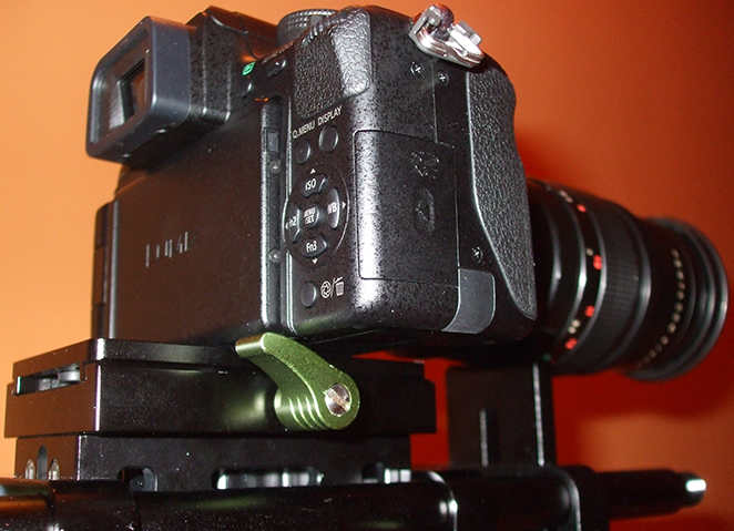

The other stupid thing about is that you can't tighten the baseplate if your camera is on it! See my pic below! You can't turn any further the green knob because of the GH2. Very stupid. Is there any solution for this? Because right now my cam is moving with the lens like hell. I need to tighten it as soon as possible.

Loosen the center screw and turn the lever counter clockwise. Tighten the center screw then the lever.
When the lever is tight (plate locked in place), loosen the center screw again and bump the camera (just like in the picture) with the lever. Tighten the center screw again.
Hopefully this will give you enough rotation to unlock the plate enough to slide it in and out.
I tried it out yet, but the semicircle round is just not enough to tighten the baseplate.
What a stupid system!
That s pretty shoddy! Either use a socket head screw or buy one of the screws with the spring loaded levers. I'd be tempted to send it back.
I am pissed off. Also this knob waggles. It has 5-6mm "backlash".
Oh, I just discovered something!
You can pull out the knob sidelong and turn it counter clockwise over and over again until you can tighten the baseplate! Too bad I didn't get a manual instruction. :) It's like a hidden thing.
Anyway, does it make a difference if there is "LPT" or "Lanparte" written on the label of the plate? How can you know if yours is original or fake?
That's the spring loaded lever I was talking about.
