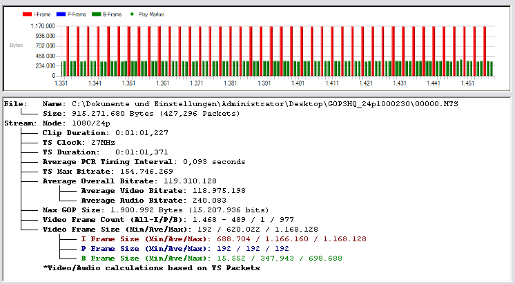

GOP3HQ
Here's a new setting aimed at PAL-users shooting 24p (24H), 25p (HBR) and 50i (FSH).
On static scenes the HQ matrix produces pretty large I-Frames. With motion the ratio of I- and B-Frames is comparable to Flowmotion 2. The result of this setting is higher IQ on static scenes while still providing very good motion rendering. All in all the setting looks very similar to Flowmotion 2, however on bright high detailed scenes it may look somewhat cleaner (sharper) than Flowmotion 2. Above all the setting has been stable in all my tests (on SandDisk 30MB/s and faster cards)… whereas Flowmotion 2 may crash under certain extreme conditions. Then again, FloMo2 shows somewhat less chroma noise.

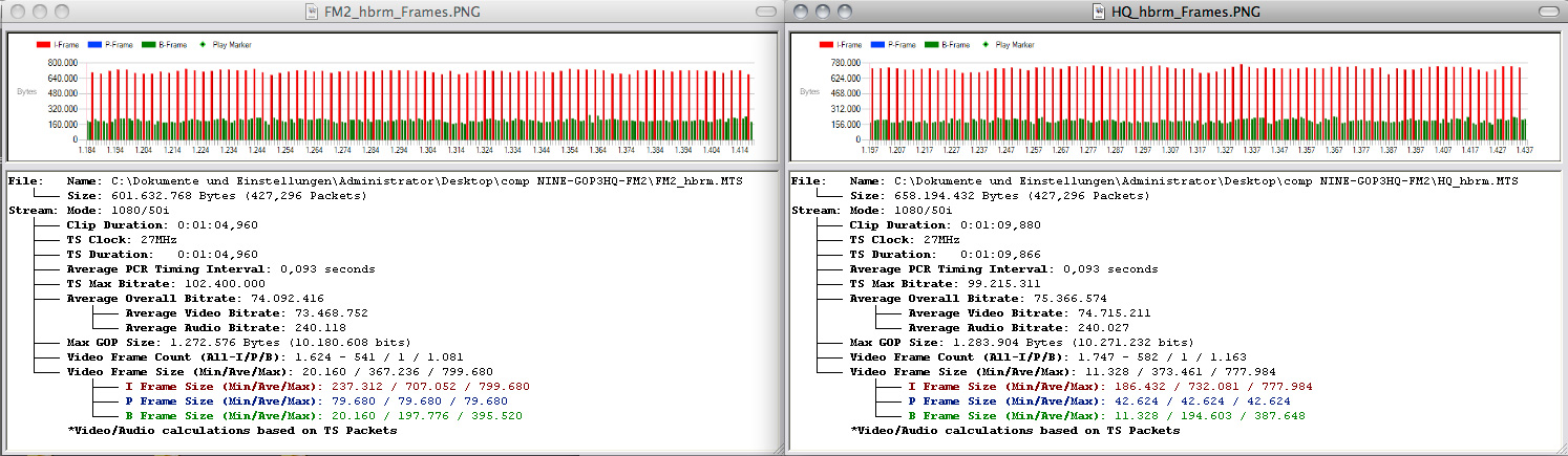

HBRp25 - FloMo2 vs. GOP3HQ, motion (FM2 on the left, HQ on the right):

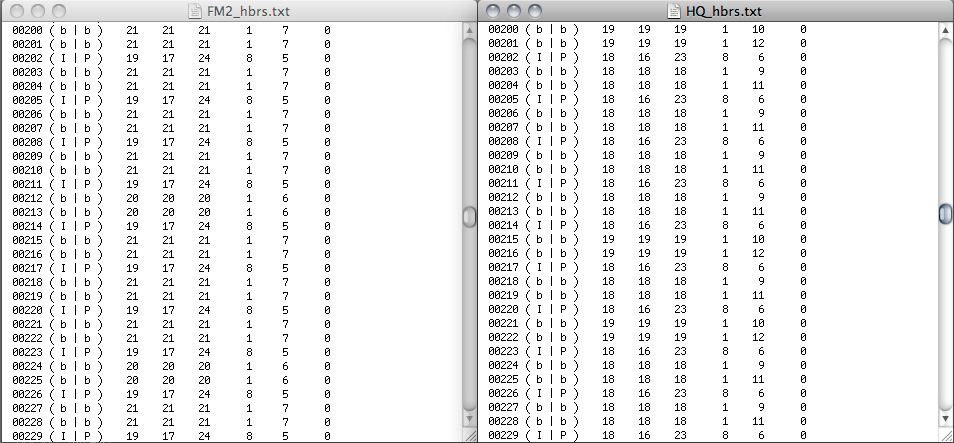

HBRp25 - QP of the same scene (Flowmotion2 on the left, GOP3HQ on the right):

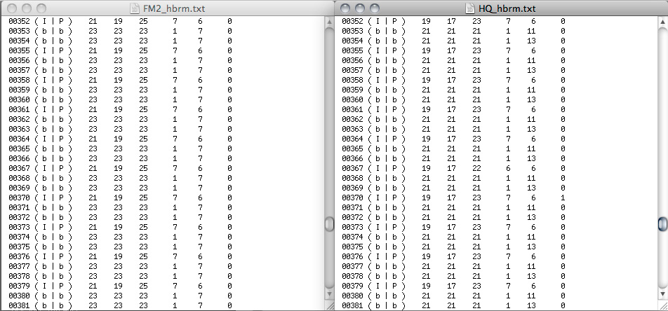

HBRp25 - QP of FloMo2 vs. GOP3HQ on a static highly detailed daylight scene (Flowmotion2 on the left, GOP3HQ on the right):
Streamparser grab GOP3HQ, 24H, static:

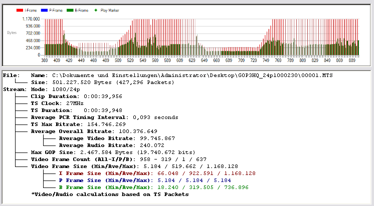

Streamparser grab GOP3HQ, 24H, fast pans:
This setting is really good for 24H, 25p and 50i - try it!

@towi I'd be interested to evaluate the original MTS files that produced your uploaded Stream Parser charts. One comparative difference that stands out is the range of DC values in each QP chart (the second column of numbers from the right). I optimized the Quantization Tables in Flow Motion v2 to produce a tight range of DC values in each GOP - typically 5-7. I believe this is crucial for achieving P and B-frame image quality comparable to I-frames.
