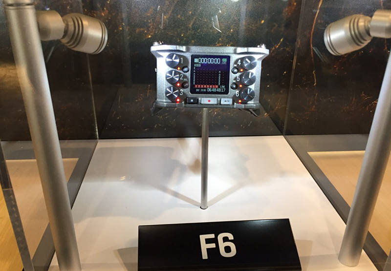

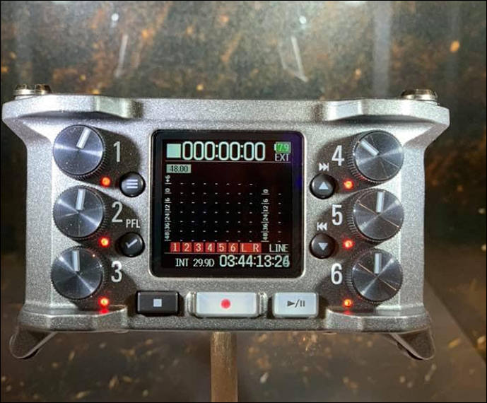

When I'd heard this was 32bit I was hoping this was going to be a recorder "above" the F8n, but I guess not.
Design is quite unusual, like from some 70-80s Sci-Fi films.
My guess is it will be priced higher than the F4 but lower than the F8 (and I don't see the F6 as a replacement for either)
So US$700ish?
But once it has been on the market 18 months it will drop below US$500 ish
I think we will see firmware updates for all F recorders that add 32bit floating format.
No way it is official info, but it is my good guess.
One of the reasons can be that Zoom want to first try water (I mean Zaxcom lawyers) :-)

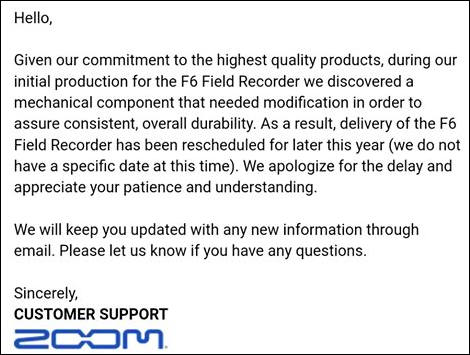

You recently placed an order for the following item - B&H # ZOF6. Unfortunately, the manufacturer has informed us that this item has been delayed until 10-01-2019
B&H sending notices.
