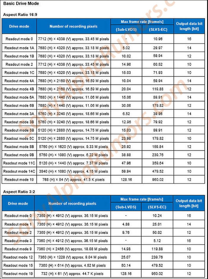

  • Sensor 1 - 60MP CMOS FF, 16 channels
    • 60MP 4.6FPS@16bit
    • 60MP 12FPS@14bit
    • 8k30P@12bit
    • 8K60p@10bit
    • 4k60p@12bit
    • FHD 300P@10bit

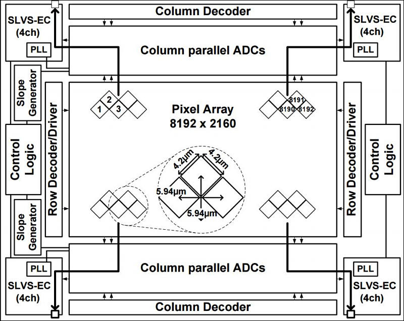

  • Interesting here is - Scalable Low Voltage Signalling with an Embedded Clock (SLVS-EC)
    In SLVS-EC, the clock signal is embedded in the data and recovered by dedicated circuitry on the receive side. Since the signals are then less sensitive to skew, the data can be transmitted at much higher data rates and over much further distances. Each of the SLVDS-EC channels can support speeds of up to 2.304Gbit/sec. The result is that a sensor that supports the new standard will be able to transfer data over eight links at a data rate of 1.84GBytes/sec (80% of full bandwidth due to 8b10b encoding).

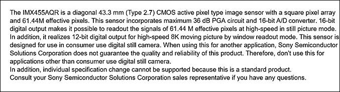

  • IMX455 is a stripped down version of the 60MP IMX551
    • Effective pixels: 9600×6400
    • Recommend recording pixels: 60MP
    • 11/12/14/16Bit ADC
    • Full Pixel 9fps/14Bit ADC
    • SLVS-EC 8Lane
    • Single ADC in Video Mode
    • 12-ADC in Still Picture Mode
    • Native ISO 64/400

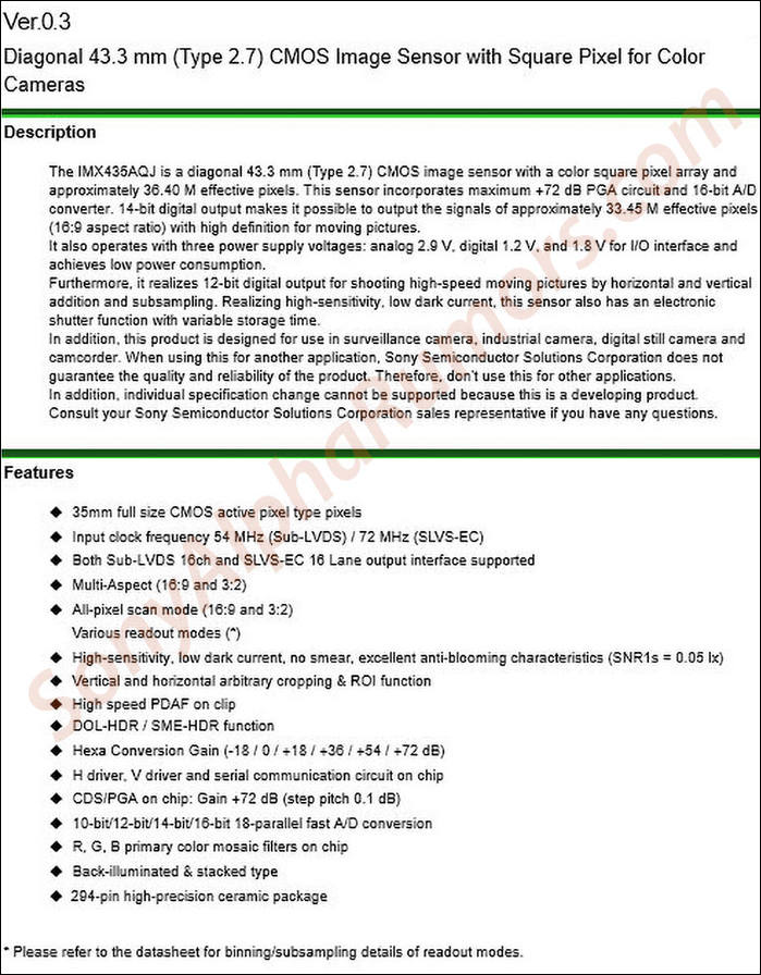

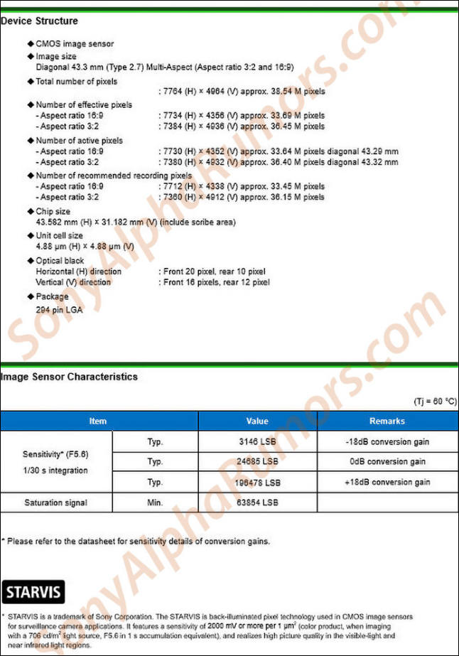

    The star of the show IMX435 sensor has 6 native sensitivities (from base to top as seen in the table):
    • ISO 50 = Conversion Gain -18dB, EI +12dB, DR 17.4EV
    • ISO 200 = Conversion Gain 0dB, EI +6dB, DR 15.4EV
    • ISO 800 = Conversion Gain +18dB, EI 0dB, DR 13.4EV
    • ISO 12800 = Conversion Gain +36dB, EI +6dB
    • ISO 102400 = Conversion Gain +54dB, EI +6dB
    • ISO 1638.4K = Conversion Gain +72dB, EI +24dB

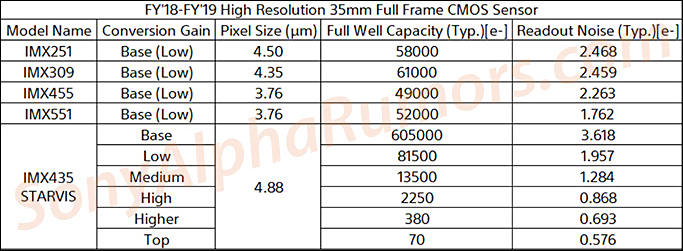

    Its full well capacity at base is particularly impressive at 605k e-, A7SII sensor IMX235 is “only” 159K e- with much bigger photosite. This again highlights the power of Exmor RS.
