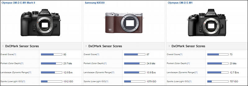

  • Olympus Mk II sensor results are up, must be very close to GH5
    It seems that Olympus implemented more aggressive noise reduction, now in raw also
    Olympus claim it’s a newly developed sensor and with lower noise, and both wider dynamic range and improved color discrimination at all ISOs it is one of the most significant upswings in performance we’ve seen in this format.

  • If I may say my totally unscientific impression, based on working a lot with NR software in post, GH5 also uses heavier noise reduction than we have previously had on Lumix models, and many other cameras for that matter, and by that it gains better apparent ISO performance, but in high ISO examples we've seen so far, NR and sharpening artefacts are obvious. It seams that they've only raised the bar of what is possible to CPU, and the bar of what is acceptable to present as better low light capabilities.

    This is also why we need good lab that is able to measure sensors and check also video and photo raw behavior.
    I am sure that in coming years we'll see more and more focus on software due to hardware limits.

  • @Vitaliy_Kiselev, I don't see any trace of NR applied to RAW's in the Em1 mk2 sensor. If it was like you said, the color fidelity would have suffered but it doesn't and the noise structure is nice, not like the higher ISO's in Sony and Pentax cameras. :)
    I prefer more formal and scientific way, as "suffering color fidelity" is too wague.
  • @inqb8tr "If I may say my totally unscientific impression, based on working a lot with NR software in post, GH5 also uses heavier noise reduction than we have previously had on Lumix models, and many other cameras for that matter, and by that it gains better apparent ISO performance, but in high ISO examples we've seen so far, NR and sharpening artefacts are obvious. It seams that they've only raised the bar of what is possible to CPU, and the bar of what is acceptable to present as better low light capabilities."
    I also had exactly the same impression.
  • @Vitaliy_Kiselev , I'm not a sensor engineer but as a photographer which used a lot of cameras in his life, I see no trances of NR applied to the EM1 mk2 RAW files. I may be wrong, yes but so far I see no trance of NR pattern like in Sony and Pentax high ISO raw files. I'm also looking forward for more scientific tests that prove or disprove this NR theory.
