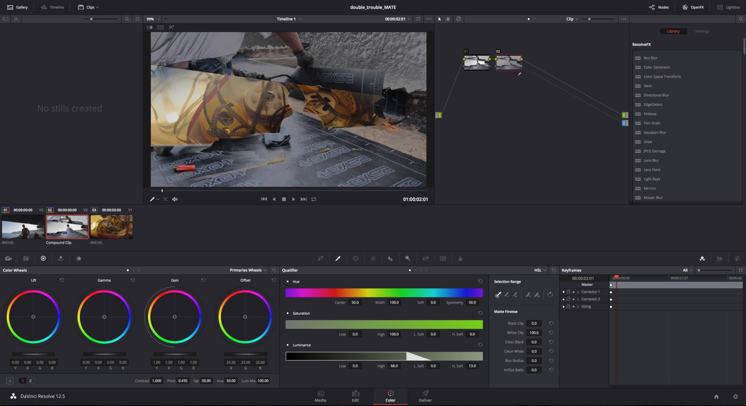

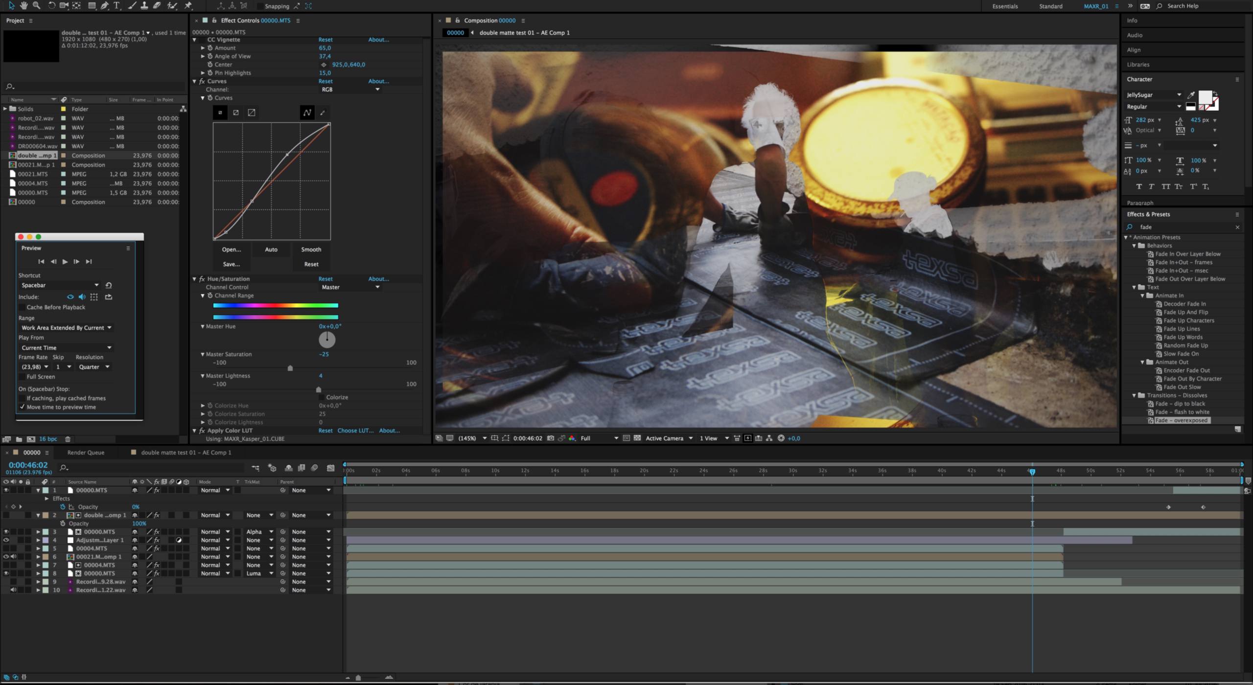

I've been trying to achieve somethin' within resolve with no good luck, maybe the cracks of the colour walls can help me out. I believe it would be easier if I explain how I already achieved this (more or less simple) effect in After Effects. So 4 layers, top to bottom layer 1 and 3 is the same and I'm using it as a matte for layer 2 and 4. Layer 1 is a luma matte, layer 3 a luma inverted. So to have and image which high lights are formed from one layer and its darks are formed from Trump followers, I mean from another layer. Result
In resolve I only managed to achieve this with one of the (compunded) layers and an alpha output
I'm aware I could export the matte from AE and then import and composite it inside DR with a matte node, but I would like to be able do the whole shibang and grade within same platform, you know lazyness is motor of long toe nails and most incredible achievements :P
Resolve is not designed as a compositing program. These kind of comps using alpha masks are possible but not flexible as you need to import dedicated masks, as the node trees are separate for each clip. Fusion is the best way if you don't want to use a compositing program like After Effects. I don't do any compositing in Resolve as it's not really suited to it... yet!

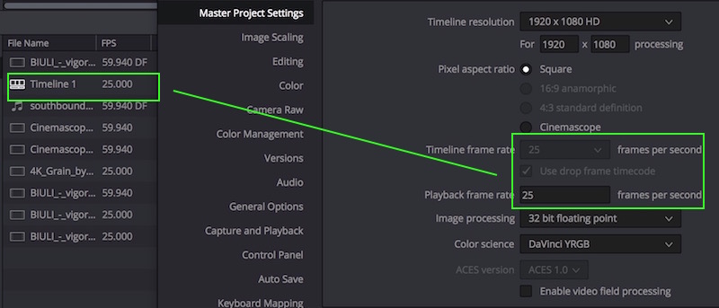

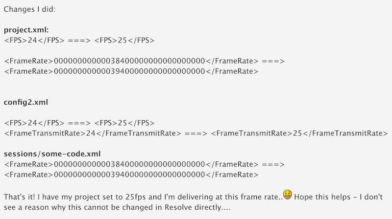

It happens... to the best and manliest of ranging dudes, and if one has been working on a long project could turn into a nasty PITA. BlackMagic's user vasikgreif found a cumbersome yet useful way of doing this:

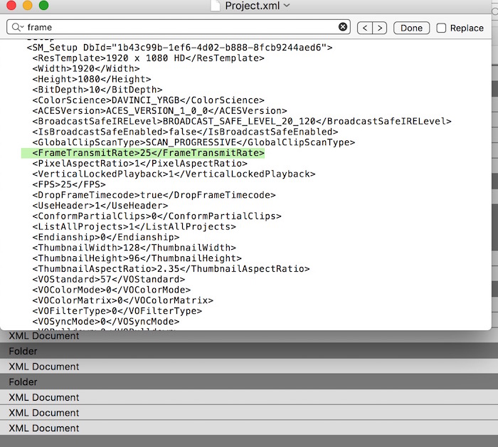

You need to go to your Resolve projects directory (here it's C:\Program Data\Blackmagic Design\Support\Resolve Disk Database\Resolve Projects\), and open the project directory.You'll see a bunch of folders and xml files. Now, you need to edit the XML files and search for some strings and replace these with some other values:
I found mine (OSX) under /Library/Application\ Support/Blackmagic\ Design/DaVinci\
Resolve/Resolve\ Disk\ Database/Resolve\ Projects/Users/panfilo/Projects/greitname
and there, were actually 3 xml files that needed tampering: the project one, the config one and the long alphanumerical one. It might be obvious but most text/code editors have a search & replace or find & replace funtionality which in a conjuncture such as this become handy.
Attaching a screengrab as I'm unable to parse some symbols through MD.
Then It's maybe a good idea not to extend the project's wraping and export the opium blast ASAP. Resolve needs to access (and modify) the xml files too, so it's possible that it can change its properties on its next launch... you can also leave the xmls open as long as you're still working in DR.

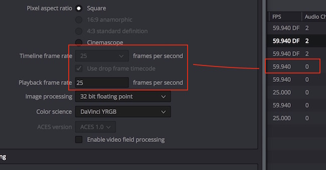

Finally before launching fireworks and kissing the turtle, double check that TL's framerate and project's framerate are same: e.g. {putting sesame st costume} WRONG
RIGHT!
