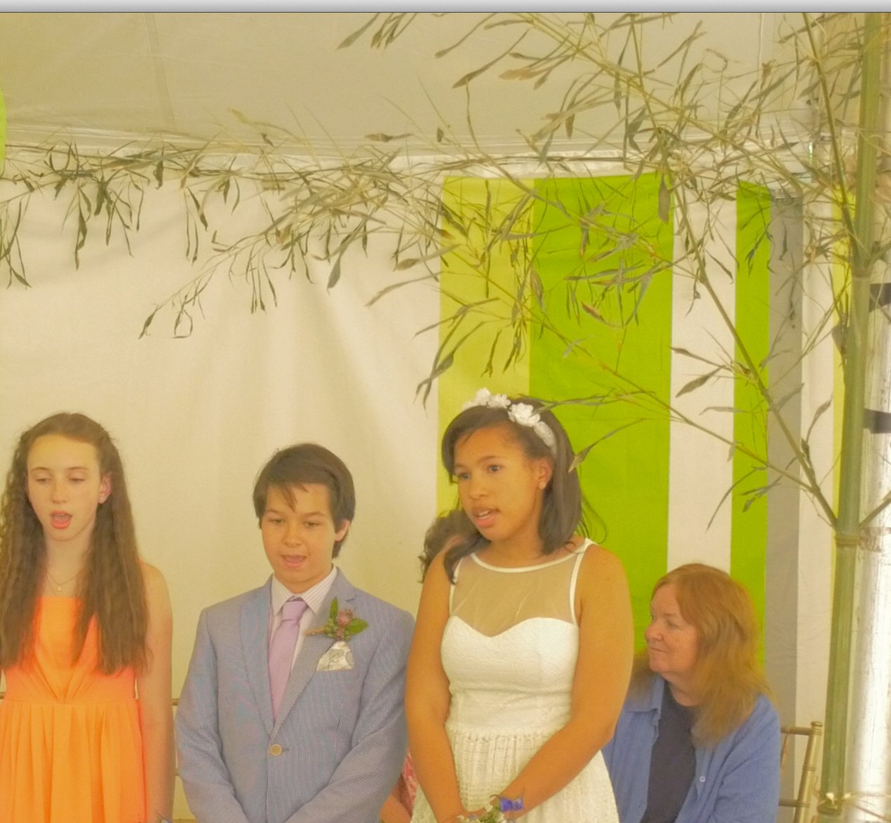

    TO my amazement I got some moire on the GH4 in UHD 4k mode on something I just finished editing (I unfortunately had to shoot & edit it) lol.
    I didn't think it was possible, but, here's the proof. Even now looking at it a week later, I had a hard time seeing it, I had to look for it, it doesn't jump out at you. It only happened at a particular focal length, which I didn't stick to for very long. Otherwise, this kid's suit gave me no problems at all.
    Shot in CineD & sharpening turned all the way down. Lens was a Panasonic 14-45 at ca. f5.6 That might have been where the extra sharpening came from… If memory serves, the Panny lenses turn on some extra sharpening (I think the test I saw was with a GH2 though).
    This is a screen grab of a portion of the 4k frame at 100% size.image
