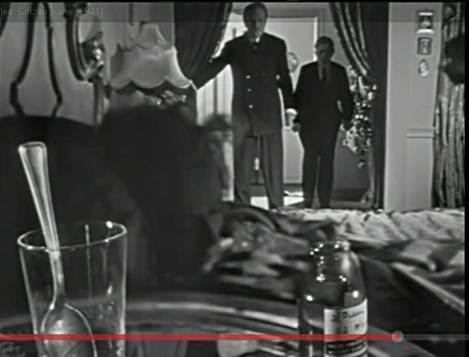

  • @matt_gh2 12-foot room? Yikes! You might have to use a 12mm lens at f/22 and do as Orson Welles did - either cut a hole in a wall or a hole in the floor:

    BTW, even as a novice filmmaker, Orson Welles so insisted on full DOF that he once refused to accept his DOP's insistence that they had to resort to opening up the aperture on a particular shoot: he asked the DOP what frame rate they were shooting at: the reply was 24 fps.Welles then suggested they shoot at 12fps, therefore letting twice as much light enter each frame, allowing them to tighten up the aperture another stop or so and finally allow the everything-in-focus look he insisted upon. This they did, successfully, with Welles, as actor walking and performing all his movements slowly so as to appear normal upon 24fps projection.

  • @matt_gh2 Good luck with the Northern Hemisphere autumn temperatures. Films like Citizen Kane appear dark, but the sets were so brightly lit and hot the actors were apparently getting suntans and sweating!
  • Or click on https://www.youtube.com/watch?feature=player_detailpage&v=Ksn_s-Aa_pQ#t=44 to start the video at second in-room scene at 0:44. image

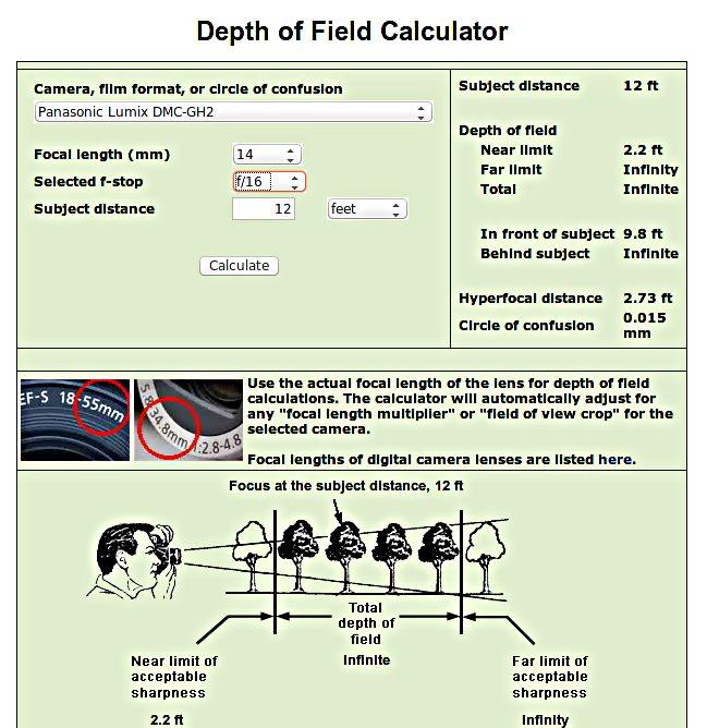

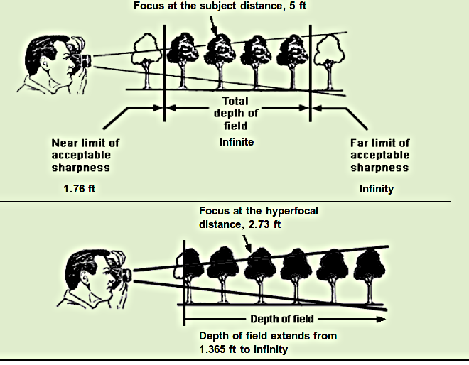

  • As usual, the DOF calculator site can be useful for lens choice as well as positioning of talent and furniture in such a small space.
  • @goanna Very helpful - thanks.
