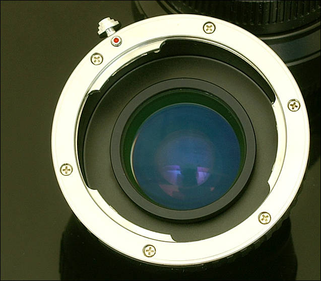

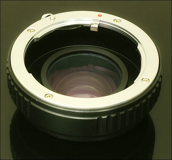

  • Leica R to m43 and Pentax PK to m43 RJ adapters are available
    Terms are all same.
