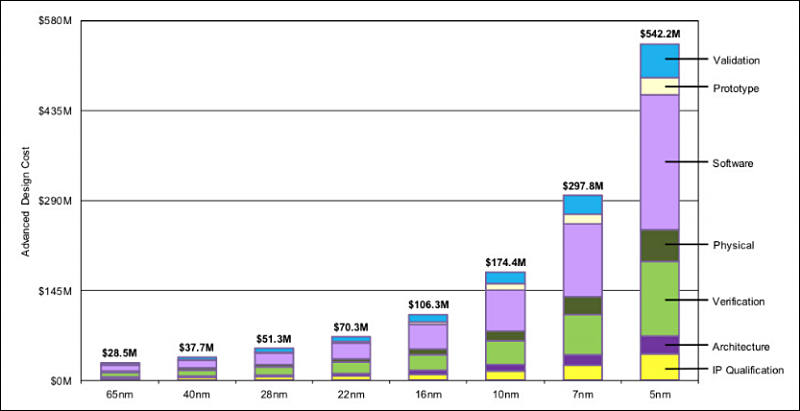

    How big are this costs?
    Non-recurring engineering costs estimates for 28nm complex image LSI are about $29 millions of dollars.
    In case of more iterations of development, producing more masks and modifications costs can be as high as $50 millions.
    All this money must be returned from chip sales inside cameras. Millions of cameras.

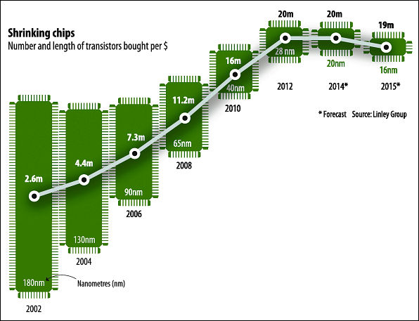

  • How many transistors you can buy for dollar:
    Good illustration of the things described here.
    Thanks @agoltz for the link.
    Via:http://www.economist.com/news/21589080-golden-rule-microchips-appears-be-coming-end-no-moore

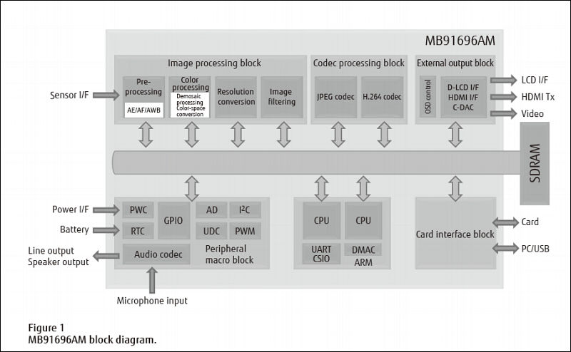

  • How modern LSI looks from logical POV :
    Check PDF in attachment also.
