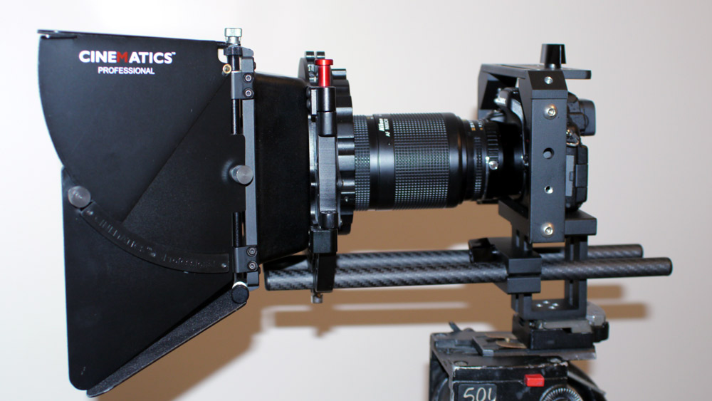

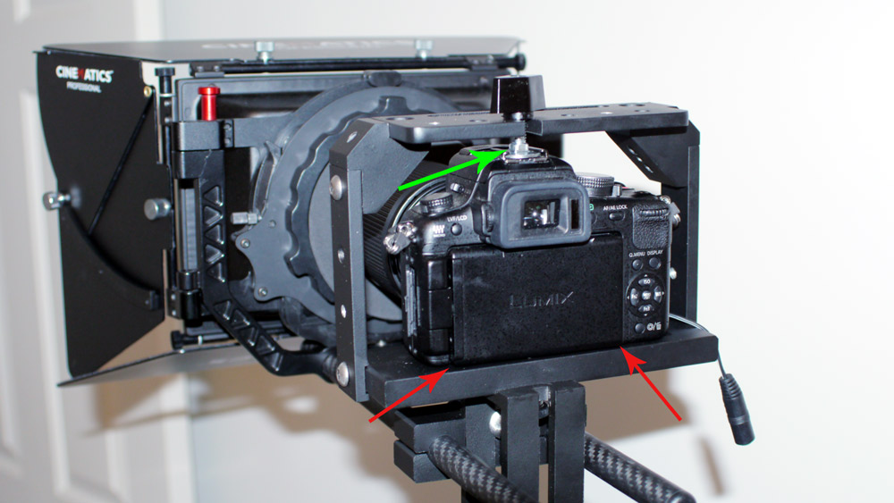

It was like Christmas here last week. Cinematics matte box showed up and about an hour later the cage and rods from indie system. Cage is well built.....nice and solid. Lots of places to mount stuff. Perfect size for the GH2 I think. The cage and rods had a small bag with 2 allen wrenches and the top bolt. Nothing else. Turns out there should have been more in it, at the very least a bolt to attach the camera. No big deal....I picked one up at the local hardware store....(hell....I've mailed out a dvd to a customer and forgot to burn the video file on the disc!!) You have to take the cage off of the rods to mount(or un-mount) the camera. Again not a major deal.....and I don't know if you would have to do so with other rod systems. First thing I noticed when I mounted the camera is that without any type of soft material...ie cork or something....the camera will spin on the cage if pushed even gently on either side (red arrows). I tightened the bolt as much as I dared to without breaking anything and it still spins fairly easy. This is a big problem initially....though I plan to find something to put between the camera and cage to stop this. Second thing....and even more alarming was that as I put on and tightened the top bolt (green arrow) I actually saw the top of the camera start to stretch up.....the top of the camera was moving up while the bottom stayed nice and tight on the cage. If I had not been going slow and paying attention I'll bet I would have pulled the camera apart or broken something. I'll need to go back to the hardware store and find some kind of spacer to fit in here. Someone asked about a stack of washers on the bolt in a picture on the original Shrigg Jig post. Something in here is a MUST!! Last is just a pet peeve of mine. The way the mount to the tripod is set up makes it impossible to balance on the tripod with a big lens and mattebox without hanging the whole thing way off the back of the tripod. In the side view you can see just how far back it is and it still needs to go back some more to balance. Shrigg mentioned that indiesystems makes a long plate so you can achieve balance....but you would still have to hang it off the back. So with a few minor mods.....I think the cage is a winner overall. I think I'm going to try a different rod system as I've noticed there are some that the mount is more forward than this one which should make balancing better.

@Marks I think your rig is very front heavy especially with the mattebox. It doesn't help that the camera is sitting so high up. Can you lower it? Once the camera is mounted on the cage, it should not spin, otherwise it really defeats the purpose of the cage. Most cages will secure the camera firmly with just the bottom screw, why do you need the top bolt for? Design flaw?
I think the price of the cage is very good, but it is not suitable if you are thinking of mounting a big lens and mattebox to it.

@PixCanFly It's that high to center the lens in the matte box, and also because of the design of the "block" that holds the rods and mounts under the cage to the QR. I agree about it being front heavy. That's because the rail mount is directly under the cage with no way to move it. It's spinning (only if you give it a push) because it's smooth camera plastic on smooth aluminum cage. If you look at the side pic you can see some cork pieces sticking up from the dovetail. I took those and placed them between the camera and cage and now no more spinning. I wasn't going to use the top bolt at first....but when I noticed the spinning problem I put it on thinking it would help....it didn't. I now have it off since putting the cork under the camera.

The GH1/GH2 spins because the tripod mount thread under the camera is not flush with the body, it protrudes about 1mm and prevents the body making firm contact with the cage base.
