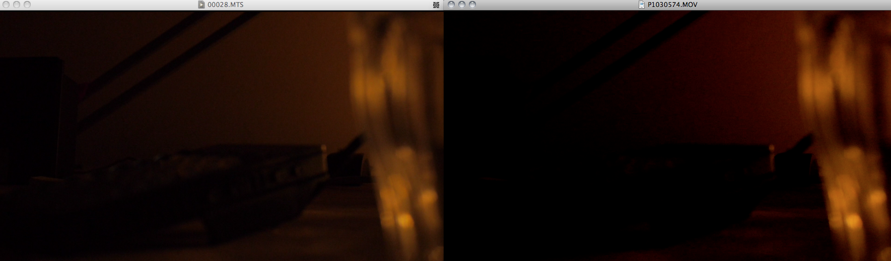

  • @mpgxsvcd I find AVCHD a better choice for low light. Mov compression on the GH3 looks harsh and too contrasty. Look at this comparison I posted a while ago http://www.personal-view.com/talks/uploads/FileUpload/52/07c27747430be3d2bd9d1935310e07.png
