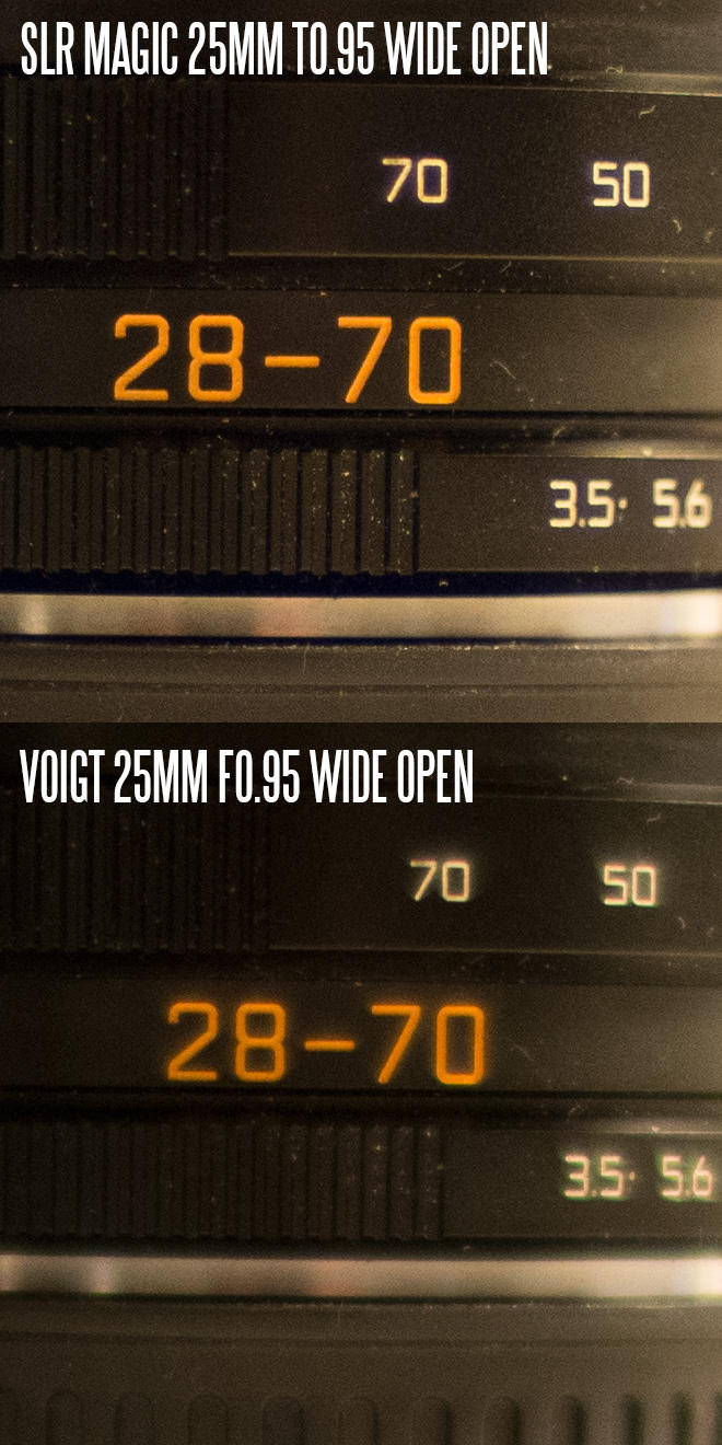

    Those two comparison shots speak for themselves. I appreciate the way the tweeter did not extrapolate or embellish.
    The shots compare an identical subject of a technical nature. They look like similar distance from lens to subject.. Maybe not.
    This is an excellent comparison for technical subjects, good fine lines and limited colours. Full marks to the tester! If I want to photograph anything like another lens, close up and in low light, I'd choose an SLR Magic 25 over a Voigtlander.
    43rumors.com however does extrapolate, using the old question mark trick, "Is the SLR Magic.. better?" to get a headline and sell some ad clicks. That's media biz. Stay tuned for blow-by-blow comparisons at 1, and 2, 5 metre distances, then skin tones right up to circles of confusion. A page for each and an ad on each page; hyperbole in the copy serving to incite a frenzy of contributors' opinions . That's the state of science in 2013.
  • Slr Magic one is sharper. No question about it. I want more thoughtful comparison.
    Bokeh look and feel, flares, CA, distortions, vignetting, maximum sharpness at f4 5.6 8, build quality, focus play and feel, etc.
  • @stonebat
    I am starting to believe the actual apertures vary, as some lenses do - and that this clears up the differing DOFs in some of the pics we've been given.
    Somebody recently quoted the SLR-Magic 25mm as really a "T/0.95" camera; and that could easily explain the sharpness. It could be like this: The SLR-M has glass elements that let in more light than the Voigtlander. Its aperture could then be mathematically or optically smaller, focusing sharper whilst still letting in the same amount of light as an f/0.95. That would explain a whole lot about the obviously different depths of field! Below, Hugo of Beeldlab Blog says he focused on the letter "P" with the Voigtlander and on the "R" with the SLR_M. But the latter has nearly all the letters in focus, while the Voigt's lens markings are sharper. The right-hand pic is even darker, dammit!
    So ignore Hugo's sloppy comparison work, tighten up the aperture on the Voigt and they'd look much more alike.

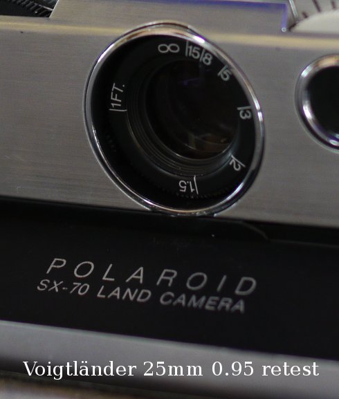

    [Edit: added a close-up of my own test from some time ago: tried to guess distance and light so as to make it comparable. But still a genuine 0.95 aperture]
    http://www.youtube.com/watch?feature=player_detailpage&v=DzSlQRewS7Q

  • If this was a "test" I have no idea why the tester would focus at different points. The Voigt's lens markings "appear" to be sharper because the SLR's lens markings are out of it's DOF, not because it is less sharp. When stopped down, I'm sure the they will be comparable, but more "tests" need to be done.

    The SLR magic is your lens for sharpness at low light. If you want shallow DOF, the Voigtlander is the one.
    Once again, take a squiz at the video link re T-stops.
    [ If we can believe the tests so far], I'd question whether the SLR-M lens iris opens up fully. Shall we call it a widest mechanical, measurable opening of around f/2 in order to explain it's wide DOF and sharpness, as observed in the sample pics? .
    Did they lie to us by putting f-stop markings on the barrel? No. They have to put them there - by convention and for exposure calculations.
    But a lens which has better glass* which lets in more light can give impressive sharpness stopped down. (Please open up that iris, I say, give me that blurry f/0.8 or whatever; I'll take care of the stopping down myself).
    *Maybe it's not the glass. It could be coating or lower reflectivity sending all that extra light at the iris. [Hell, they may even have some way of concentrating more light onto the iris. (singing)~ Birds do it, bees do it, Meta-bones & magni-fying glass do it].. .
