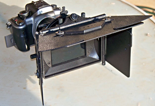

    I am loving this tiny matte box. Yesterday I shot lots with Panasonic 14mm pancake. I currently have the top flag adjusted so it only just clears the FOV of that lens.{I'm absolutely sure it can be raised further but I can't work out what Cavision want me to do with their screw/lock nut/rubber grommet combination].
    All plastic but the design is impressive. You'll need their 10 thick mm step-ring, say 77-85mm diameter. I've had to order this later. I will keep this permanently attached to the m/b and use a series of xx->77mm step rings to fit all my lenses.

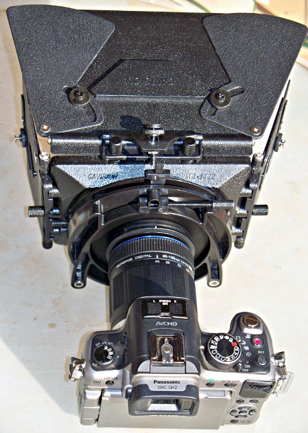

  • Mounted on Olympus 45-150mm zoom. Using Cokin-P filter. MB is light enough, but I support it with one hand while changing focal lengths. I never do zoom shots.
    image | image
    8mm rig $79.95 at http://www.bhphotovideo.com/c/product/310716-REG/Cavision_RS_816_RS_816_8mm_Light_Weight.html image
    8mm carbon fibre Rails with adjustable base plate reputedly only available at Cavision. They say B&H are selling old stock with fixed plate.
    626 x 427 - 78K
    449 x 632 - 131K
