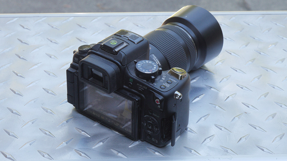

  • My GH1 is still working fine except for one little detail: the SD card door no longer snaps shut. I can see that the cause is a tiny ridge on the inside of the door that simply wore out over time.
    Does anyone happen to have a dead GH1 they could donate to fix my old GH1's SD card door? This particular GH1 has quite a history, as it's the camera I used to develop all five of my original GH1 patches. In addition, it was retrofitted with Panasonic's unhackable version of the GH1 firmware after I was forced to send it back to the factory for warranty service. As a result, it became one of the first unhackable GH1's to be hacked by Vitaliy's breakthough version of PTool that liberated all GH1's. After such a momentous career, it'd be an indignity to have to tape the stupid door down with duct tape. So if you can, please help!

  • I had exactly the same issue on that crappy SD card door and I asked for it to be repaired under warranty, but they insisted I send the whole camera (instead of sending the little piece of plastic). So I took a needle, an index card and some slow setting crazy glue and used the needle to build up a thin ridge on the outside of the door plastic. And in fact, it then worked better than the original. Still waiting for the refined quantization tables for the GH1 so I can go back to no noise video!

  • @LPowell - did you fix this in the end? I have same problem and have been using velcro, which is becoming annoying!
  • @leftedit Yep, fixed it just like @DrDave described!
