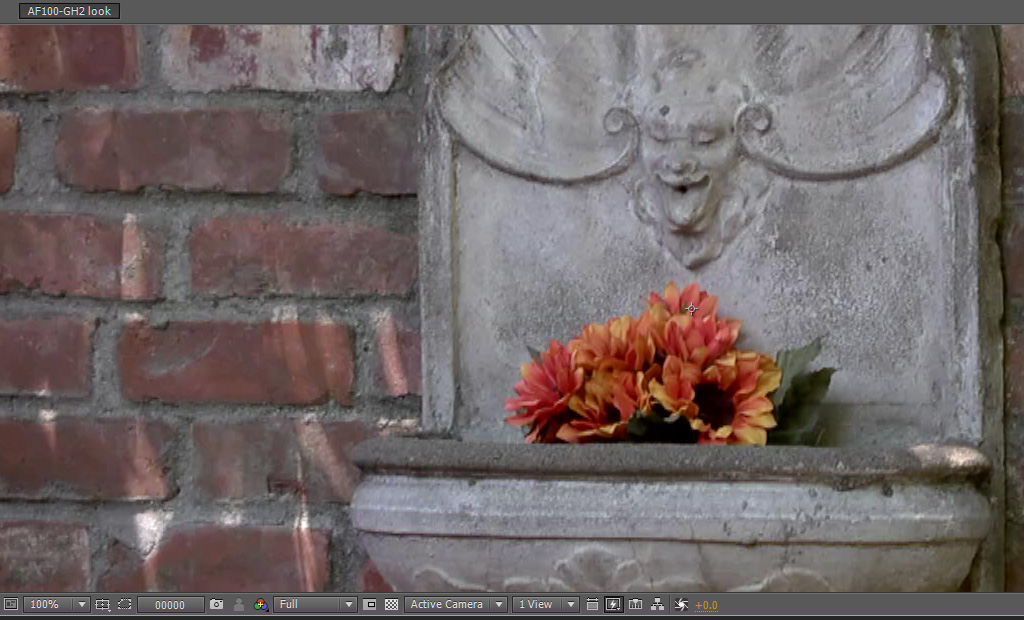

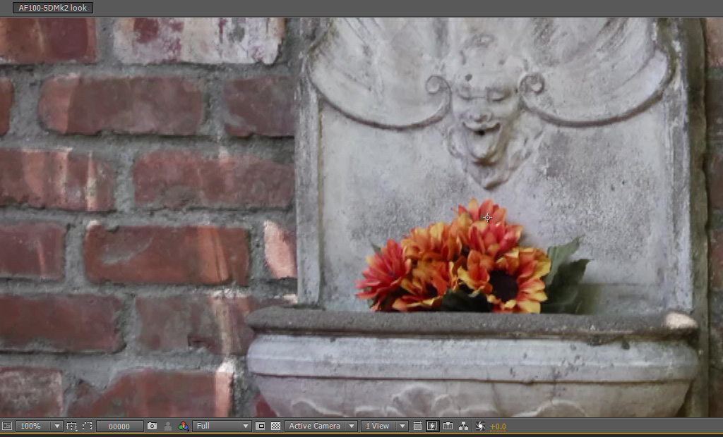

@Onionbrain I suspect a large part of the AF100's reputation for poor detail and soft image quality is due to the type of Scene Files recommended by folks like AbelCine and prominent posters. The advocates of these settings tend to favor low Detail and rather high Pedestal and Coring (noise suppression). In some cases, these shooters are seeking to match the look of the Canon 5DMK2, which itself is quite soft. My experience in using the AF100 along with the GH2 has led me to quite different conclusions.
Here's a direct comparison of unedited 100% crops of AF100 footage:
AbelCine 5DMK2 Scene File for the AF100:
http://blog.abelcine.com/2011/04/06/af100-scene-files-created-by-abelcine/
LPowell GH2 Scene File for the AF100:
AF100 GH2 Scene File
Gamma CINE-LIKE D
Matrix NORM2
Detail Level -2
V Detail Level -2
Detail Coring -7
Chroma Level -1
Chroma Phase 0
Master Ped -9

@onionbrain I pretty much agree with your points as well. The AF100 is a bread 'n butter camcorder that serves well in situations where all-in-one convenience and traditional broadcast practices outrank image quality. For me, the main value is in its connectors: MFT lens mount, XLR inputs, and HDMI/SDI outputs.
The Master Pedestal setting is a curious thing. The reason I lowered it was to match the GH2's contrast range. But that also reduces shadow noise and increases highlight headroom, so it's an all-around win.
