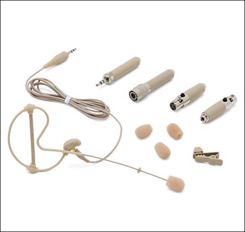

    For speaker you need this (to make it as close to mouth as possible just not before it to avoid breath noise):
    It is small electret one, also larger dynamic ones exist (if you do not have small electric supply required for electret you can use it).

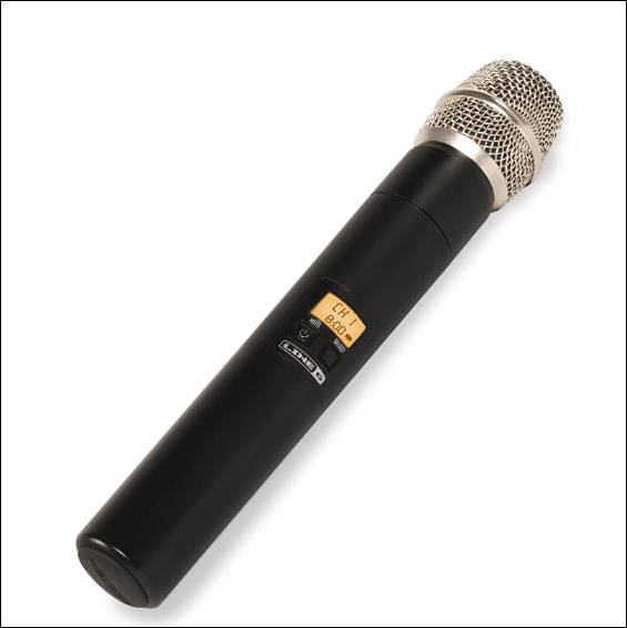

    For audience you never use shotguns, just get good wireless dynamic microphone and ask to hold it close to their mouth
    I suggest to look for newer digital systems, including Line 6 (as it has no level adjustments, very simple).

    @Vitaliy_Kiselev Thanks - I haven't looked at headset mics before but I can see how that would help get closer to the source and reduce noise -I'll check those out. I was thinking of looking at the Rodelink The Newsshooter kit once it's available to keep things portable for hand held mics but the Line 6 looks like a much cheaper option for conferences/indoor.
