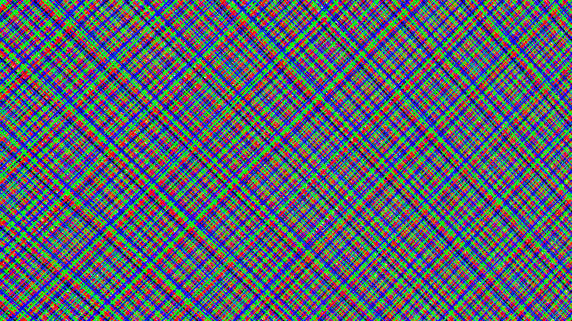

    All of the patches that record higher then about 45mbps in the 720/30p mode will fail on you. I am trying to save you the time and frustration of testing each patch and wondering why they are failing on you. You stated that you want to run the patches successfully like everyone else above 45mbps, this is exactly the problem that I am talking about. Based on all the tests that I have performed all of the patches that record above 45mbps in modes other then 24p will fail on you.
    Caveat to what I stated above is if you are recording clips or videos for short periods of time. However if you test any patch on this website in the 720/30p mode with the Death Chart for at least 1/2 hr with native Panasonic lenses you will see that all of them fail except Cake V2.3. So like I said knock yourself out, but you are wasting your time thinking that you will be able to record reliably with bitrates higher then 45mbps in the 720/30p modes.

    Exactly! As I stated above, you will be able to record just not reliably with anything higher then 45mbps in the 720/30p modes regardless of the card/patch that you have. I have tested this extensively on the GH2 save your self time and frustration. The strength of the GH2 is in the 24p mode, if you use it knowing its strengths and weaknesses and work the strong points then you will be happy with this camera.

    Shot this yesterday. With Drewnet T9 in 720 60SH mode. 30+ minutes down to 30seconds.
