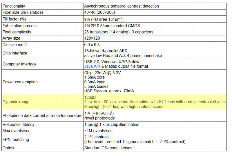

IniLabs, a spinoff from the Neuroinformatics Institute at the University of Zurich, has developed a new sensor, known as the VS128 DVS, which eliminates many of the limitations of conventional cameras.
Rasterized images require a comparatively large amount of time and energy for processing because of all the redundant information they collect. The VS128 eliminates the need for expensive post-processing and compression by never acquiring redundant information in the first place. The key to achieving this is to do away with conventional frames and instead convert the information in a visual scene to a more supple currency — spikes.
