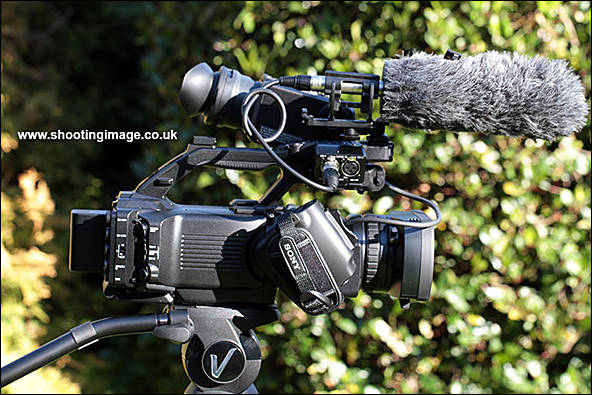

    Initial impressions are very favourable. Sony really did listen to feedback on the EX series and following the earlier PMW-100, PMW-150, PMW-200 launches. The PMW-300 has so many little improvements over its predecessor, and a few important big ones too. The sum total of these changes makes me feel the Sony PMW-300 is a very big jump up from the Sony PMW-EX3. It seems so much more of an accomplished and user friendly camera than it looked on paper when I was comparing specs. Build quality, amazing and fully removable viewfinder, great codecs, improved image with better noise reduction (60db as opposed to 54db is quoted - that’s a big step!), better shoulder pad design, improved button layout, ability to clip review much faster without needing to reboot the camera…
    http://www.shootingimage.co.uk/MoreInformation/SonyPMW300/SonyPMW300.html
