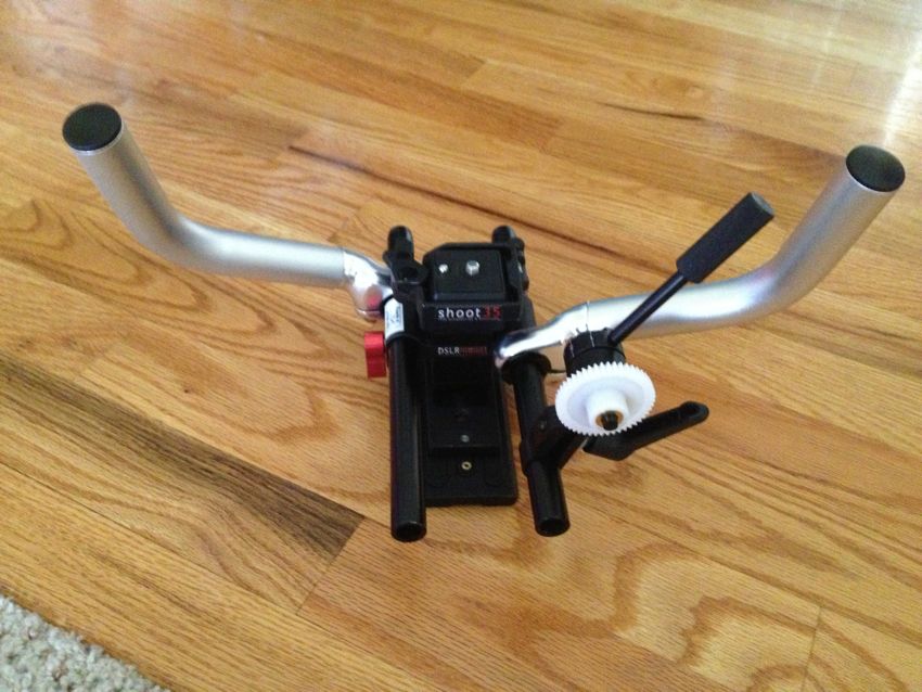

With this you'll get a good two handle solution for under $40.
360 degree rotating (so they face the right direction) Mountain Bike Bar Ends. http://www.ebay.com/itm/360581573227?ssPageName=STRK:MEWNX:IT&_trksid=p3984.m1439.l2649
Berkey System Handle Bar Sleeves. They usually send out one plastic one and one metal one. Ask for two metal ones, they grip better. http://www.berkeysystem.com/store/hand-grips-and-accessories/handle-grip-sleeves/
And just pick up some $10 bicycle handle grips from your local bicycle store to slide over the bar ends.
You can mount them going up for the rods to have a handheld solution or you can mount them down from the rods to complete a shoulder type rig. I bought this set up and it is a better solution than any other more expensive solution I've tried.
I'll post more pictures soon once I get the handle grips put on and I have a camera around to mount on it.

More pictures with the grips added as well as my GH2 on the top.
