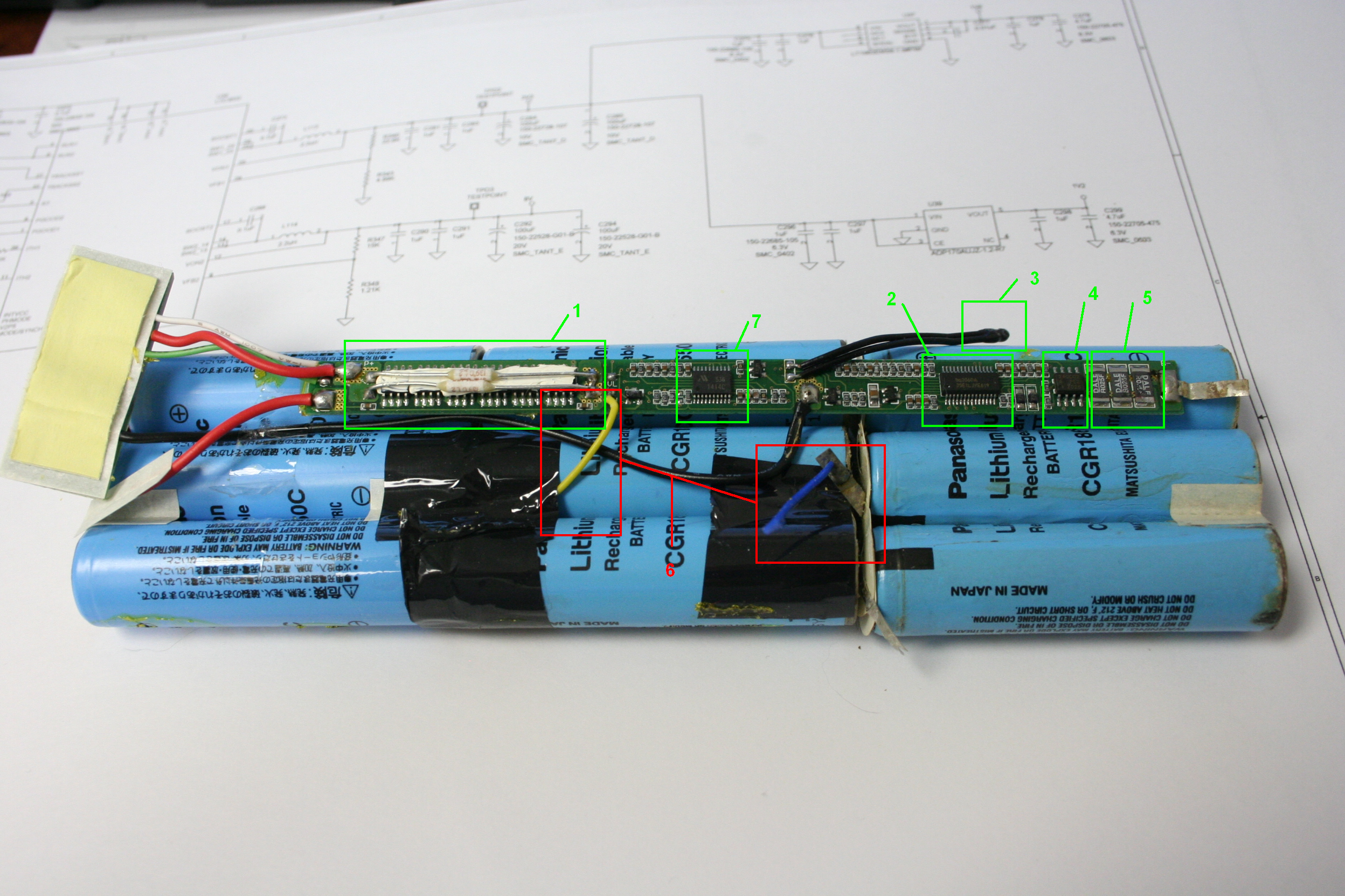

  • So, I've taken the liberty of documenting a picture of the inside of a Li-Ion pack that I designed.
    1: Thermal fuses and MOSFETs for cutoff. These cut off the power in/out of the cell in case of excessive charge/discharge/temperature.
    2: GasGauge IC: This communicates with the charger and monitors the charge/discharge/temp/currents/voltages, etc, to make sure the pack is healthy.
    3: Thermistor: This is how the gasgauge checks temperature.
    4: EEprom: Stores the manufacturer battery settings for charge/discharge rates, etc.
    5: Current sensing resistor array: Low ohm resistors across which the current is measured.
    6: Current/charge/balance sensing: these wires sense loads and balance between cell banks to make sure that each cell is balanced to the others to ensure none of them are charged or discharged differently.
    7: Specific protection IC: This IC is what controls the MOSFETs. This IC communicates to the gasgauge IC and also listens on the SMBUS for warning flags from the charging IC in case the pack needs to be disconnected for safety.
    As you see, these packs are NOT simple and there is a LOT going on inside of them that you are not aware of. These protection devices are NECESSARY and are not there for making profits. If you want someone who makes profits, look at the chinese making the Li-Ion packs that do NOT have the protection installed and wait for them to fail and/or cause fire. Those packs are for profit because they WILL fail and cause a fire and those guys don't give two shits if they do or not.

  • @svart
    And why not have all this build into notebook and allow people to insert individual cells (with independent cell charging ability)?
  • Some of the smaller single celled devices and Li-poly are starting to do that because they can monitor single cells much easier. Multi-celled systems still need cell balance monitoring (monitoring each bank of cells) and it's just easier to do that inside the pack itself. I expect that as Li-Poly becomes more mainstream and the newer, safer, battery chemistries start to come out, it will happen. Some of the new small "rechargable" Lithium batteries available in common sizes, AA, AAA, etc, have special protection built into them which makes them usable without monitored protection, but they have limits on current density and size. The larger, high-density, cells still need monitored protection.

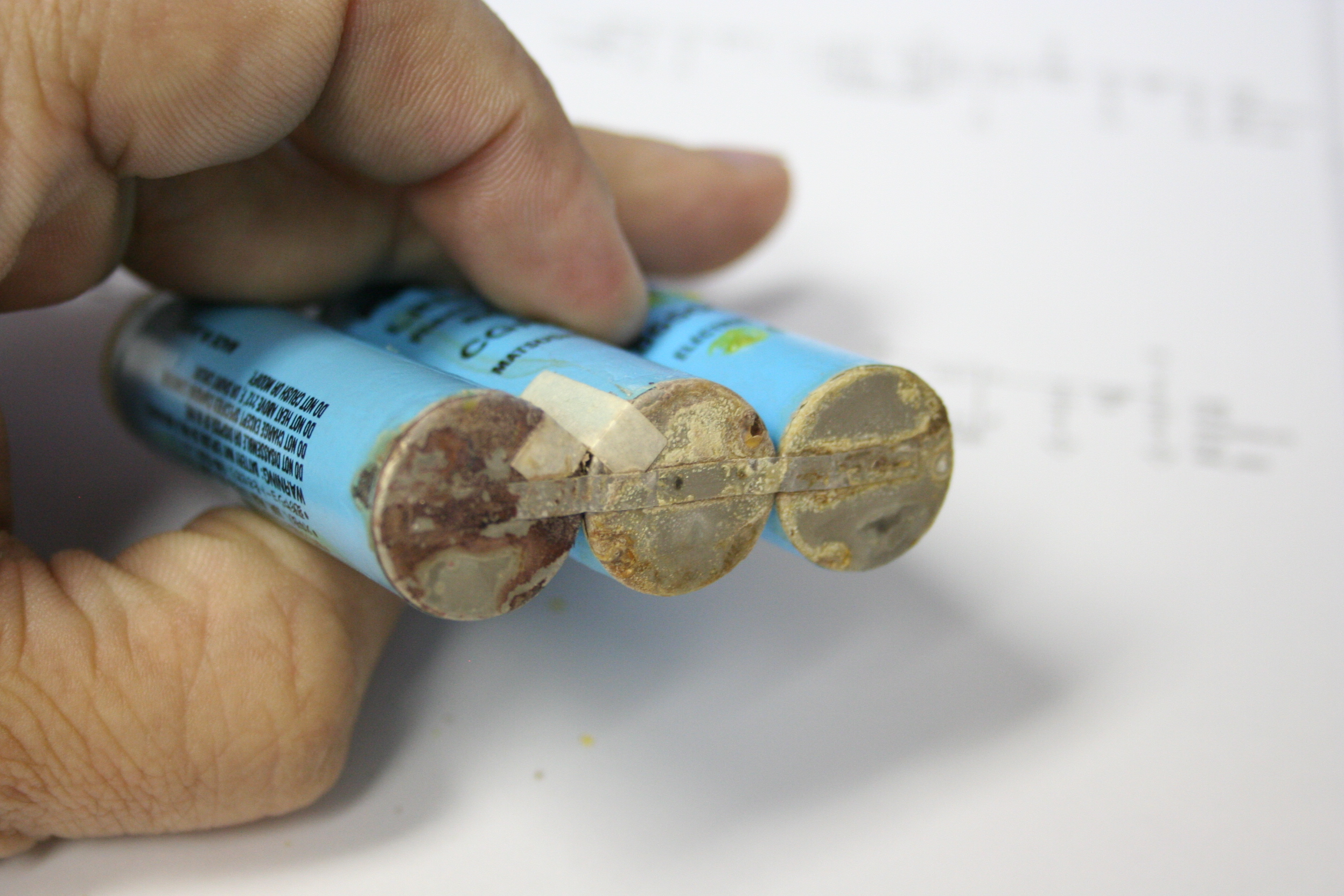

    This is what happens when a Li-Ion battery is charged/discharged or simply left without a charge for too long:
    The cells will spontaneously corrode from the inside and can catch fire as the lithium gel reaches the air/moisture. Luckily, these have some chemical suppression to keep that from happening but can still happen if it gets bad enough to reach the inner layers.

  • @svart: The different approaches to load LiIon/LiPoly cells vs. NiCd/NiMH are not news to me. But once you use (individually) protected LiPoly cells connected in series, not organized in "banks", there is no balancing stage required (yes, the least capabale of the cells will then determine the point at which further discharging is prevented by the protection circuit), and since one of the major contributors to prolong the lifetime of a LiPoly cell is to best keep it between ~15% and ~85% charge all the time, it may be a good idea to stop discharging earlier, anyway, and to not necessarily exploit the capacity only reachable by the final CV loading stage.
    And regarding cameras, we are talking about usually not more than 2 (sometimes 3) cells, so it would not be difficult to house individually controlled, user exchangeable cells.
    Regarding...
    ... have a look at "SECTION 19: Battery Disposal Instructions" at page 10 of this safety data sheet. Interesting advise, given the danger of catching fire you mention.
    Regarding...
    ... or simply left without a charge for too long
    ... isn't it then very dangerous how LiPoly cells are glued into consumer devices that are almost sure to be left unused in some drawer for a very long time, somewhen throughout their existence? We all know the advices regarding primary cells - to remove them whenever a device is not used for a longer time. But there is no such advice - and with glued-in batteries no such possibility - to do that with most LiPoly batteries.
    Last but not least, the only LiPoly battery that "ballooned" on me was an original, chipped Sanyo battery charged in an original Sanyo loader. And the only person I personally know who actually experienced a Lithium battery catching fire was the owner of a MacBook, with built-in original batteries. And the large scale product call backs we saw from various notebook manufacturers were not because of any charging/discharging issue or 3rd-party parts, but because brand manufacturers delivered poor quality cells destined for cell-internal short-circuits.
  • @Karl
    Just because you can place a polymer underwater to deactivate it, doesn't mean that a battery that has been abused and the elemental lithium has precipitated out of the ionic gel won't catch fire.. Because it will. The key is that the lithium in a polymer is not the same reactivity as elemental lithium, especially the newer chemistries, as you attempted to use as an umbrella justification. These manufacturers are trying very hard to make a much safer lithium battery, not just for our good, but so they don't have lawsuits if one catches fire. Also, as lithium metal is highly reactive, once placed in water, you'll get this reaction: 2Li+2H2O=LiOH+H2. Yes, H2 is hydrogen gas, which is highly flammable. Think Hindenburg..
    Anyway, the explanation to the salt water is that salting the water for the Li-Po battery is creating a medium power discharge path through the electrolysis of the water and the water itself is conducting heat away from the pack so that the cells don't go into thermal runaway. It's nothing more than that. No magic, no special properties of Li-po packs. Nothing. Unlike Li-ion cells, Li-Po packs are made from layers of plastic, foil and wire and are WATERPROOF unless scratched.. Then the same rules apply as Li-ion.
    Anyway the same industry rules apply for Li-PO as Li-ion as far as safety regulations are concerned though. All else is just agenda and propaganda.
    While gluing Li-po packs into devices is technically dangerous, they STILL have active monitoring and active protection systems involved. These protection systems are designed to cut the battery off if it gets too low in charge. Li-Ion and Li-PO have very low self-discharge rates unlike NiMh. Some of these Li cells can sit for years or decades before self discharging. The protection circuits are setup for being dead-man switches. Once they have tripped and turned off they do not use power from the cells, you need to give them a "wake up" current for the gasgauges to reinitialize and test the internal cells. The manufacturer simply expects you to use the device until the battery has lived it's life and you are expected to recycle it. In either case, unfortunately, the manufacturer is not liable for any disposal and doesn't typically care what happens. The industry has typically downplayed the safety hazards of Li-based batteries. There have been hundreds if not thousands of cases where batteries in laptops, phones, toys, etc have burned people or burned down buildings. They've burned up planes, hangars, cars, boats, etc, too. Trust me. I've been around folks who designed packs that burned down houses and stuff.. It's a legal nightmare.
    And as you pointed out, the manufacturers didn't have recalls due to protection circuit problems, they got faulty cells. You will rarely see protection circuit faults because these are VERY heavily invested in. Manufacturers know that they are on the hook if a battery catches fire and burns someone. That's a big-time lawsuit waiting to happen. They will skimp on features but not on protection. If they do, then they shouldn't be in business. All the circuit protection in the world won't protect against faulty cells unfortunately. However, this won't stop manufacturers from designing protection circuits and making specific batteries so that people can't use batteries in improper places.
