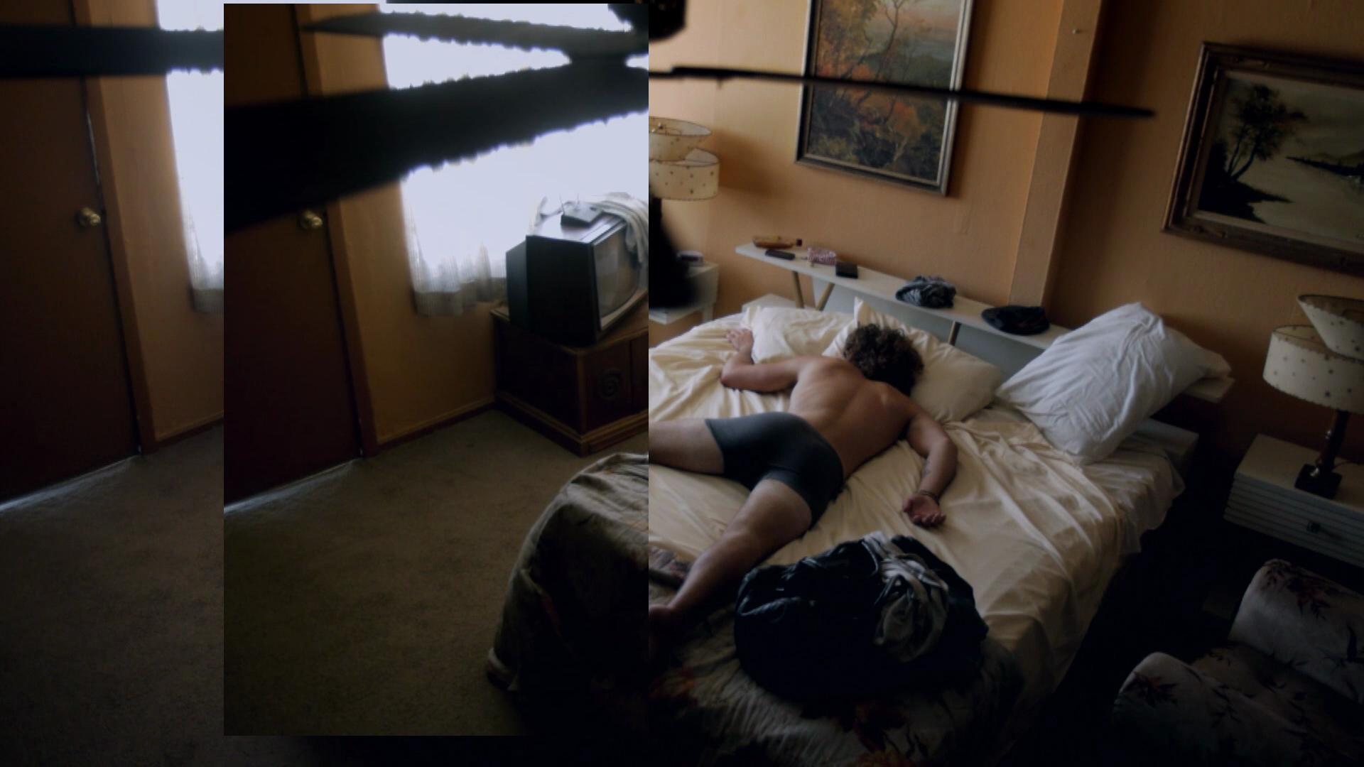

  • My GH2 footage has been having this terrible, terrible flickering. I've attached an example. In the first couple clips, look at the lightning-like flickers on the left side. On the last two clips, which I've looped since they're so short, it's just ridiculous. The footage is ruined.
    Some info:
    This is the Sedna patch. Can't remember which Sedna. At first I thought it might've been the new lens I bought, 20mm f/1.7, but I realized that can't be it because I went back to footage from a few months ago before I had the camera and it had the same problem.
    Is something wrong with my camera? Should I change patches? What is this terrible, footage-ruining flickering? It has happened at all different ISO, different f stops, shutter speeds, etc... So it's not a problem, or at least it shouldn't be a problem, between my shutter speed and the lights. At first I thought it might be the weird electrical current in my girlfriend's apartment but again, I saw that it happens in all kinds of settings with all kinds of lighting, natural daylight, indoor lights, outside light posts, etc... It also seems to be worst on the left side of the frame.
    Here's the thing though: It doesn't always happen. I took some footage of a Halloween parade in low light last week and it was fine. This is really frustrating. Here's a link to the video for an example of what's happening:
    Edit: I just realized after compressing it for Vimeo that it's not showing up AS much. Uncompressed it looks god awful. But still, the last clip that's looped is probably the best example of what I'm talking about. Any help would be much appreciated. Thank you!

  • These are the flickers I've always been talking about and nobody seems to take it seriously. It's present in the stock firmware under certain conditions and is also present in every patch that I've tried under the same conditions, low light with large area underexposed. It's even present in the GH3 footage out there. If you go frame by frame, some frames will have different tints of color in the noise over large areas of the underexposed places.

  • @thepalalias I usually see it in a frame with a large area of midtone that is slightly underexposed. The exposure meter may or may not show underexposure and there may even be am overexposed area. A good place to recreate it is a fairly dark bedroom with gray walls. The practical lighting will show a normal exposure but gray walls and dark floor/bedding will randomly show this strange tinting. It seems rather random in timing too. I can step through a scene frame by frame and it doesn't seem to happen with any type of cadence and it usually shows only in the midtones but not the brighter areas and sometimes not in the blacks. I showed a screenshot of it in the GH3 thread from Bloom's video. I'll see if I can find it..
    http://www.personal-view.com/talks/uploads/FileUpload/f1/5cc8e5d622aa870a29e4d606be5744.png
    And look in the carpet and walls. Different tints.
    It seems to be an artifact of the codec itself. Because the GH3 shows this, it's pretty obvious that they used the same code base from the GH2 and just updated it with the improvements. This is one thing I wish panny would fix rather than some of the other benign stuff people are asking for.
