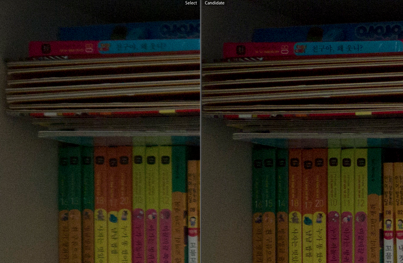

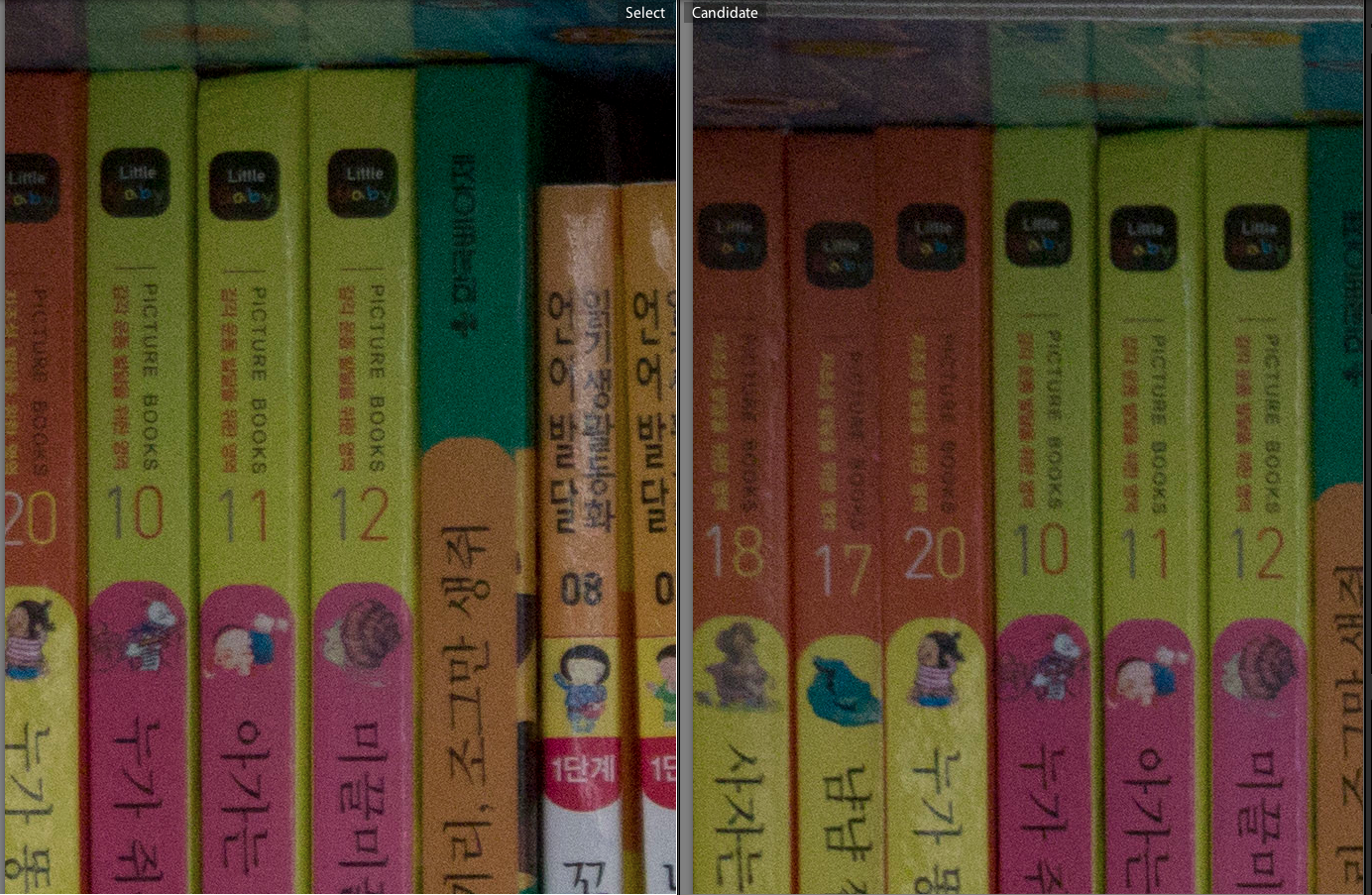

    upper left corners on sample photos shown here.
    14-45 5.6 @45mm on the left is sharper.
    14-45 3.5 @14mm on the right is sharper.
    1384 x 903 - 2M
    1373 x 895 - 2M
