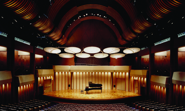

    in 2 weeks, I will shoot a classical concert (orchestra), on a great looking concert stage, with two GH2s. One's going to be a static wide shot and the second one will shoot close up and different angles. The concert will run about 90 minutes total. The location will be bright enough, but I'd say I most likely will have to use an ISO of 640 or 800 in order to be able to shoot with an f 5.6.
    I do own two fast 64 GB 95mb/s SandDisc cards. - I'll be shooting this in 24p.
    I certainly want it to look as good as possible (with as fine a noise grain as possible - considering my ISO), but I also need about 40-50 minutes of continuous recording time per segment - and the full 90 minutes should fit on each of the 64 GB cards.
    I'd really appreciate any real world feedback for this kind of task. VBR or CBR? What kind of bit rate should I be going for? Would any of the new Driftwood patches be suited for this?
    Thank you so much in advance.
    --- Markus ---

    I will use three cameras - the two GH2s will be more or less my lock-down cameras. I'll also use a Canon for close-up work - a 60D (which I have used successfully in the past at this loaction) Luckily the intimate concert hall (Zipper Hall in Los Angeles http://s3.amazonaws.com/pa-spaces.production/attachments/950/Zipper%20Hall%20piano%20wide%20angle%203x5.slide.jpg?1300312961) is gorgeous, light-brown wood interior, the players are going to be all young (no problems with gray hair!) and the lighting is beautifully soft and even from above - no harsh or uneven spots on certain groups of players. It's a dream location. There is stadium seating and from the back of the (small) theater you get a nice elevated look of the entire orchestra. There are no harsh reflections on any instruments (thanks to the soft overhead lighting) and the only thing that's really blowing out is the conductor's score, but there is not much I can do about that.
    I won't be able to walk around and I can't do super close-ups of single instruments and players. I only need some good general coverage with 3 angles to keep the editing interesting. I'd love to do a 5-6 camera shoot one day for the kind of projects @DrDave is talking about. My coverage is just one element for a short documentary and at the same time, it'll be a document for this orchestra.

  • Sounds like fun. You actually do not want lighting from above, if you think of a photoshoot you want the lighting to be from level and slightly above with not to many harsh shadows. Top down lighting will create an odd snow cone effect and grey on black on the wide shots of the full orchestra. See if you can meet with the lighting person to get some nice side lights going. It is OK to have the conductor score blown out, but again, with a G10--which you could rent for a day--you can get a wider dynamic range, or use the touch screen to use exposure tracking for the conductor and the score. The conductors score is in a really bad place, so it will be the first to go "over" Last thing I would say is, either use the stock firmware on one cam, or go with a patch that you have tested and retested for spanning. I just can't see the advantage of super high bitrates at the risk of the card crashing, plus the IQ will be essentially the same--flowmotion at the lowest setting will double you bitrate from stock (12-15 indoors) to 30, which is plenty for what you are doing, except for maybe tymp rolls. In post, if you set your levels to capture superwhites you can maybe restore some of those details.

  • Sounds like some fun THX. If you haven't yet I would mention that you should go down there with your GH2 beforehand and see what show lighting really looks like and what ISO you will be able to shoot at. Sorry If I sound like my mother. Sounds like you have probably already done that.
  • @Bueller - you are absolutely right. But I did shoot a concert there already last fall. Only I didn't have my GH2 then - I was a Canon guy until early this year.
    The good thing is, the orchestra is going to do a full rehearsal right before the actual concert - with the actual lighting and everything. I'll have 2 hours to get everything set up optimally. Without that luxury, I'd be very nervous, since you never know what your'e going to get... ;-)
