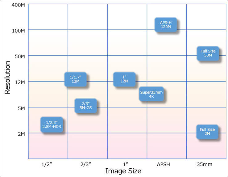

Canon announced 5 special CMOS sensors

    Canon Full Frame 50MP CMOS Sensor
    Full frame CMOS solid-state color image sensor (43.2mm diagonally), 50.6 million effective pixels in asquare pixel array. High definition, low noise, and reduced dark current.
    • Filter Type - RGB
    • Sensitivity - 32,000 e/lx/sec @Analog gain x16 (TBD)
    • Sensor Size - 35mm Full size (36 mm x 24 mm)
    • Number of Effective Pixels 8688x 5792 (Horizontal x Vertical)
    • Pixel Size - 4.14 um x 4.14 um
    • Shutter - Rolling shutter
    • Maximum Frame Rate - 6.8 fps (All Pixels)
    • Saturation - 38,000 e (TBD)
    • Dark Random Noise - 2.5 e rms @Analog gain x16 (TBD)
    • Dark Current - 9.6 e/sec (TBD) @package reverse side 60℃
    • Drive Frequency - 24 MHz (recommended)
    • Output Channels - Data: 16 ch
    • Output Format - 16 ch analog outputs
    • Power Consumption - 1.5 W (Typ.) @All pixels readout 6.8 fps
    • Power Supply Voltages 5.5V, 4.8V, 3.3V, 2.0V, 1.8 V, 1.5 V, 1.3V, 1.2V, -1.4V
    • Package Type - 104 pin ceramic QFP
    • Package Size - 55.2 mm x 44.35 mm x 2.74 mm
