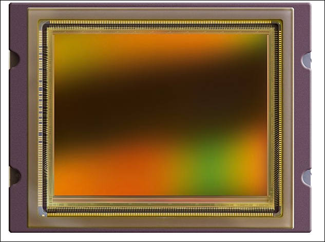

The CMV50000, which features a 35mm-format 7920 x 6004 array of 4.6µm-sized pixels based on a patented eight-transistor pixel architecture, is a breakthrough in CMOS image sensor performance. It operates at a fast 30 frames/s with 12-bit pixel depth at full resolution or a binned 4K and 8K modes, and even faster – up to 60 frames/s – with pixel sub-sampling at 4K resolution.
