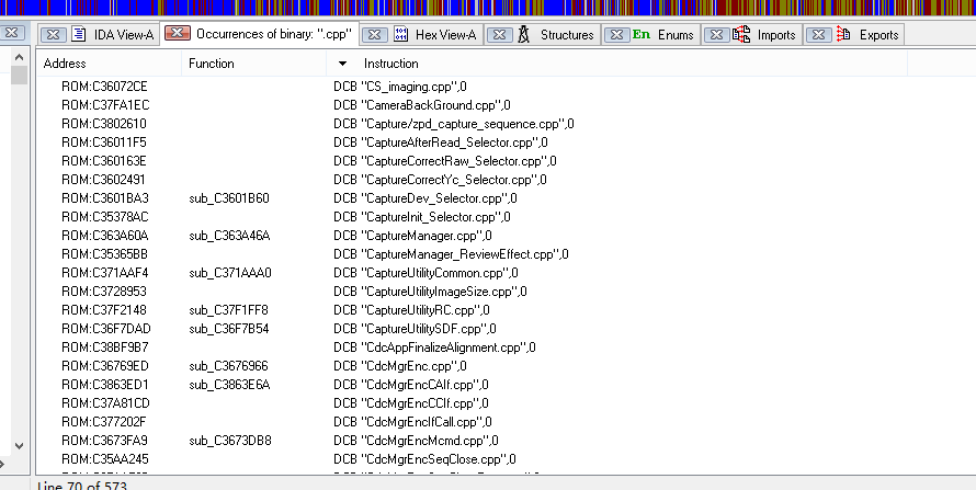

List of source cpp file names found:

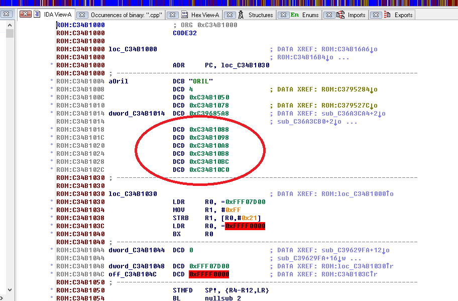

In different NEX model, av-cam.bin module is relocated in different address, you can adjust it accordingly by referencing the address info in the red circle of the following picture. In NEX-5N FW 1.02, that address is 0xC34210xx, so you can rebase the module to 0xC3421000.
