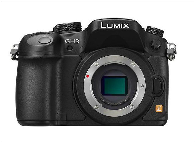

  • Effective Megapixels - 16.1 Megapixels (17.20 total)
  • Live MOS/17.3 x 13.0 mm (in 4:3 aspect ratio), not multi aspect

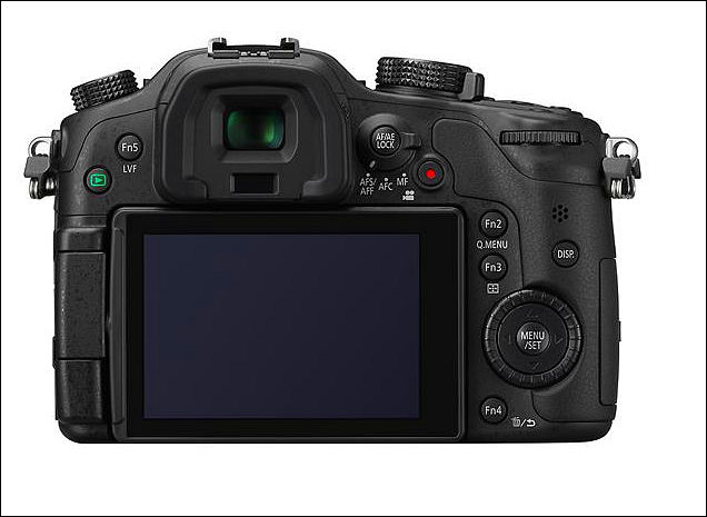

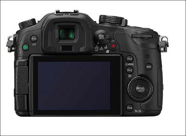

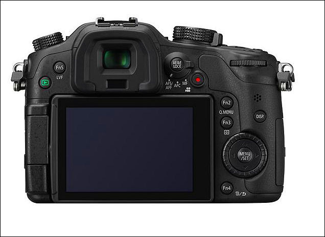

  • 3.0” 615k OLED Monitor with capacitive touch control
  • EVF - OLED 1.74Mpix
