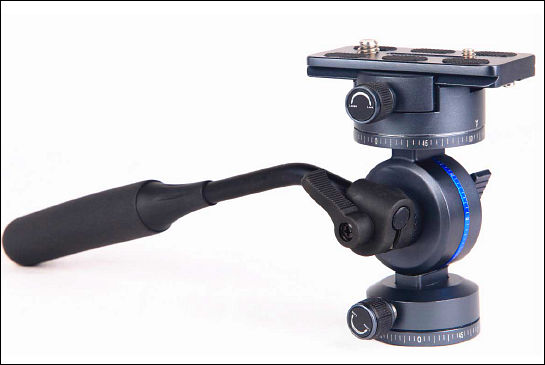

Primer of sturdy and light system (new series of NEST tripods and their small new fluid head):
