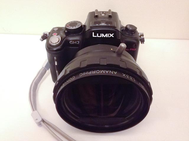

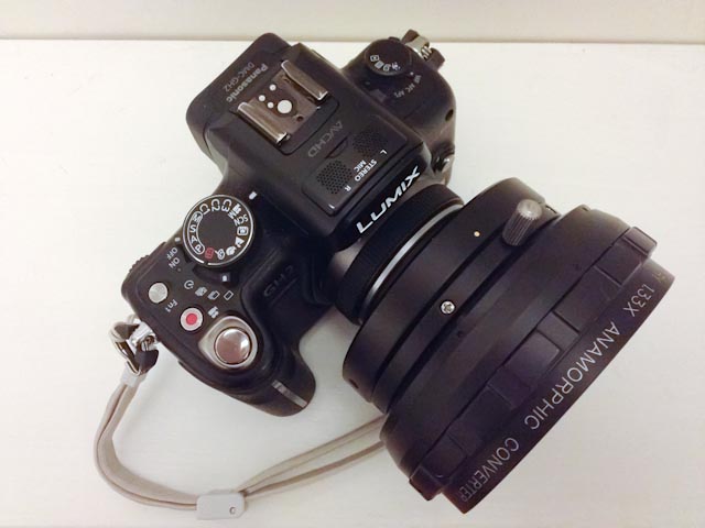

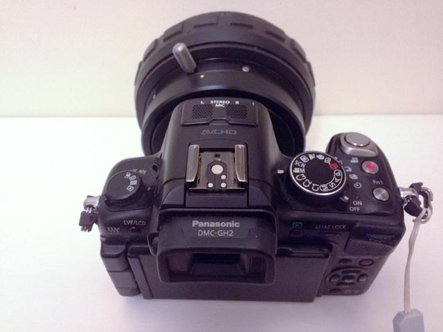

  • Anybody tried the Century with the Panny 14mm 2.5 ?
  • Just a hunch, but I'm guessing it's going to vignette. It'd be worth trying with an LA7200 though, maybe, the 14mm having such a tiny front element, maybe it might work. Just looking at the picture it seems quite a bit smaller than the rear element of the Century. My 14-42mm starts to vignette below about 18mm but even its, smallish front element, appears noticeably larger than the 14mm pancake prime.
    You peaked my interest.
  • Had vignette on the 20 1.7
  • @soundgh2 I'm betting that's from however you're adapting it to your taking lens. I've seen multiple videos of folks with the 20mm and no vignette at all. It's also, like the 14mm, got a smaller front lens element than my 14-42mm kit zoom and I can go to 18mm wide with that one.
    ...ah, here's a guy with the 14mm 2.5 and the Century working. It doesn't say anywhere that he had a diopter. For certain types of shots the extreme BD would be pretty cool.
  • I've got no Vignette on the 20 1.7 with the LA7200 (just posted a video in the Driftwood settings thread only with 20 1.7), and I understand the 14mm (as well as the Olympus 12) to work as well.
  • @BurnetRhoades was a super slim step down to 46mm straight on the front - its very slight but was there - dont have the Century anymore or the 20 so cant have another look - used a Tokina 0.4 on the front which worked well with one of RedStans front clamps improved the quality a lot.
  • I've got one of the last new 37mm Century Optic adapters and I believe I can put it on the 14mm pancake without vingetting, but I'm not sure. Also I believe it will vignette with the stock 14-42mm. I'll check later tonight. EDIT: Got delayed and now I can't find my adapters to mount the lens to either the pancake or the kit lens.
    Even with a plus 1 diopter the corners are a bit soft. One thing I've always wanted to try is to mount it on a cctv or c mount lens. With the GH2s ETC you can zoom past the blurry edges. And it might work with some of those ultra wide fast c mount lenses. I've done it with the 14mm pancake, but I don't have any c mount lenses.
    Does anybody have a 12mm or wider c mount and a century optic adapter to try it out?
  • I'll try handheld, I have a 10mm Kern Switar but no rings for the Century yet (just got it lended to me).
    Could you try the 14mm 2.5 for me, please?
