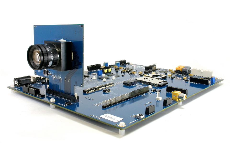

  • ====== Ambarella A9 4K Ultra HD Camera Development Platform ======
    Feature Summary:
    • 4K Ultra HD video recording @ 30 fps.
    • High definition video recording at 720p @ 240fps and 1080p @ 120fps.
    • Burst mode support for still image capture of over 700 Megapixels per second.
    • Multi-exposure High Dynamic Range (HDR) imaging support, including local tone mapping, preserves image details in high contrast scenes.
    • Electronic Image Stabilization (EIS) with rolling shutter correction.
    • 3D Motion-Compensated Temporal Filtering (MCTF) with de-ghosting for reduced artifacts and low light performance.
    • Support for applications including wireless preview, playback, and upload of stills and videos to a smartphone or directly to the Internet over WiFi.

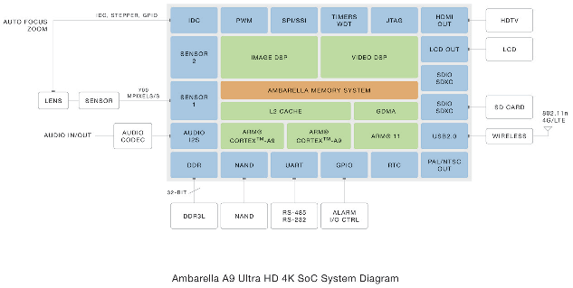

    • Interfaces such as DDR3L, USB 2.0 host, HDMI, and SDXC SD card.
    • Low power – <1W for 1080p60 encode, <2W for Ultra HD 4K encode.
    The A9 Camera Development Platform contains the necessary tools, software, hardware and documentation to develop a state-of-the-art network-enabled Ultra HD camera design.
    Hardware Platform:
    • Main board with A9 and sensor board with C/CS mount lens
    • Sensor: Aptina, OmniVision, Samsung, Sony--many choices available Software Development Kit (SDK)
    • Royalty-free libraries for ISP, 3A, and codecs
    • Demonstration DV/DSC camera application with full source code
    • Extensive and fully documented middleware API library suite Documentation
    • Programmer's guide, application notes, API documents
    • SoC data sheet, BOM, schematics and layout files
    Official announcement: http://www.ambarella.com/news/33/74/Ambarella-Introduces-4K-Ultra-HD-Video-for-Next-Generation-Mirrorless-Sports-and-Digital-Still-Cameras.html

    Besides the obvious hardware specifications, I am pleased to see the openness and flexibility of the platform. As I understand, the Dual Core ARM Cortex-A9 CPUs should be enough for basic imaging data applications including data streaming. Fabricated in Samsung's 32nm HK-MG process, "the A9 offers very low power consumption, enabling 4K resolution video cameras with small form factors and extended battery life."
    Anandtech ( http://www.anandtech.com/show/6652/ambarella-announces-a9-camera-soc-successor-to-the-a7-in-gopro-hero-3-black ) has discussed the A9 and compared it with the previous generations of Ambarella's camera SoC, A7, that is used for the GoPro Hero 3 Black (the Hero 3 White and Silver have A5S SoC), built on Samsung's 45nm CMOS process. "The A9 SoC also includes two ARM Cortex A9s onboard at up to 1.0 GHz, up from the single ARM11 at 528 MHz from the previous generation. Ambarella claims under 1 watt of power consumption for encoding a 1080p60 video on the A9 and under 2 watts for 4K30 capture. The A9 also has built-in support for HDR video capture by combining two frames - thus 1080p120 becomes 1080p60 with HDR enabled. I got a chance to take a look at both HDR video capture on the A9 as well as 4K30 video encoded on a development board and decoded using the same board on a Sony 4K TV. I came away very impressed with the resulting video quality, clearly the age of 4K/UHD is upon us with the availability of inexpensive encoders like these that will make their way into small form factor cameras."
